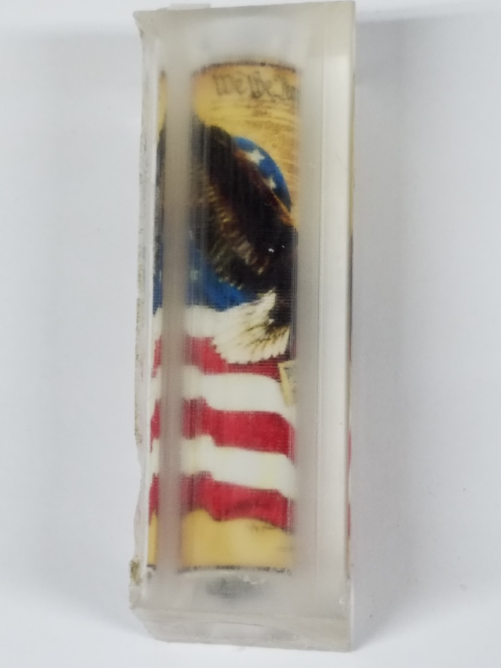

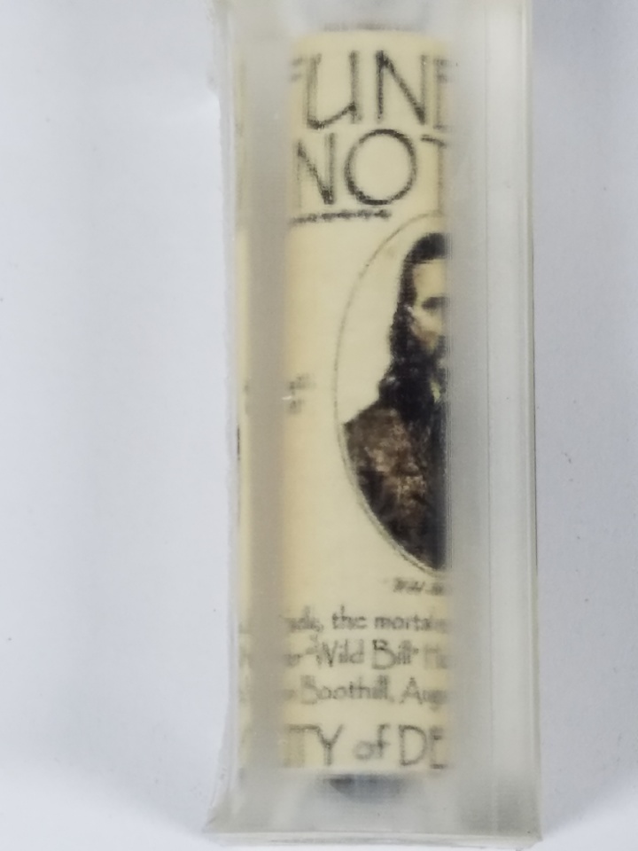

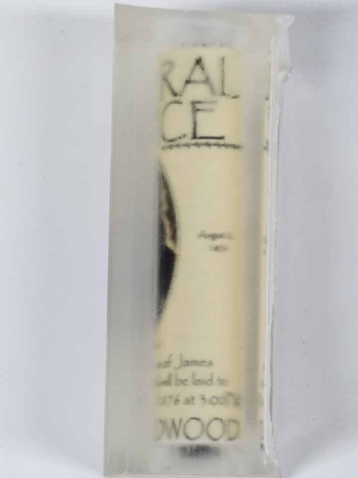

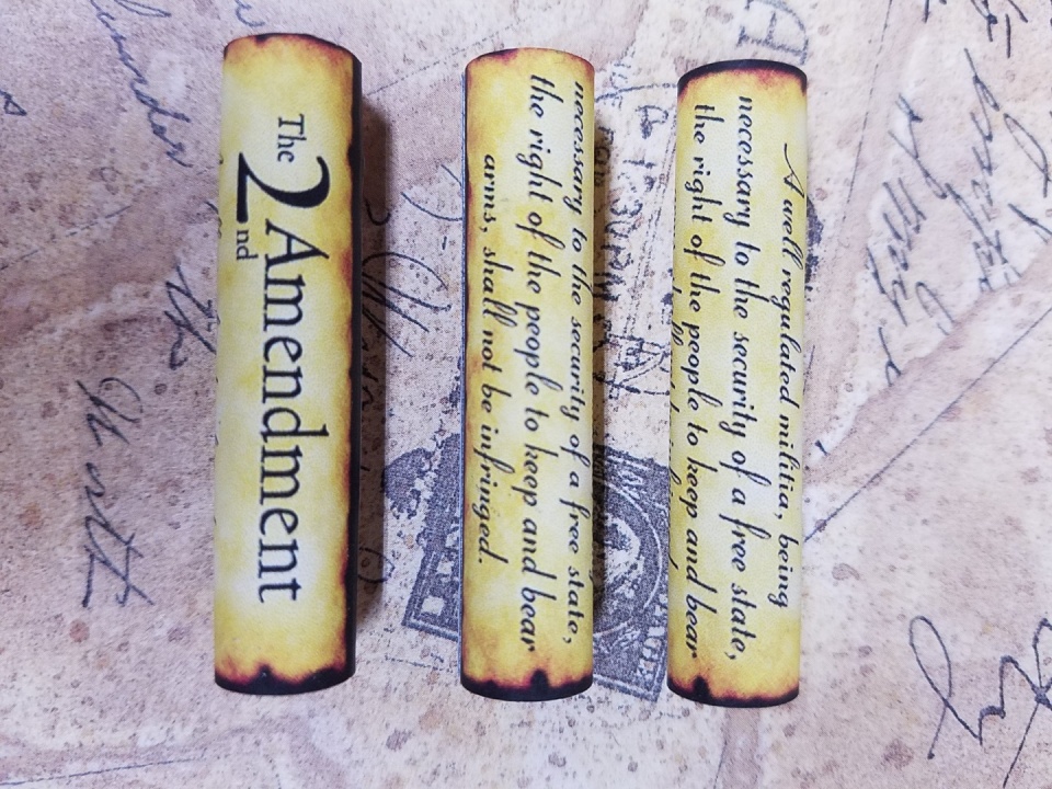

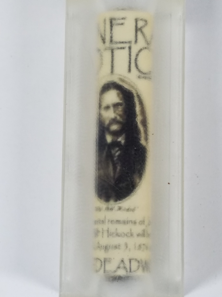

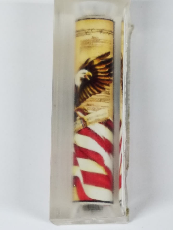

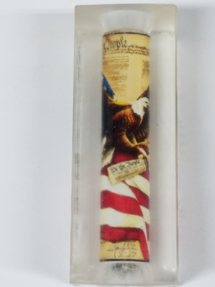

Some more pen blanks that I have cast using Liquid Diamonds resin. I am printing out labels on a label paper I got from Online Labels. It is a weatherproof matte paper for inkjet and it makes the possibilities for custom pen blanks unlimited.

Those look really good. Did you have to use any sort of spray like Rust-Oleum to seal the ink? I heard you have to do that when using Liquid Diamonds.
So far I have not had any problems with the ink. The label paper I am using is made for inkjet printers and I have printed the labels and cast them in the same day with no special precautions taken. That's not to say that it could not happen, I just haven't experienced it so far.
