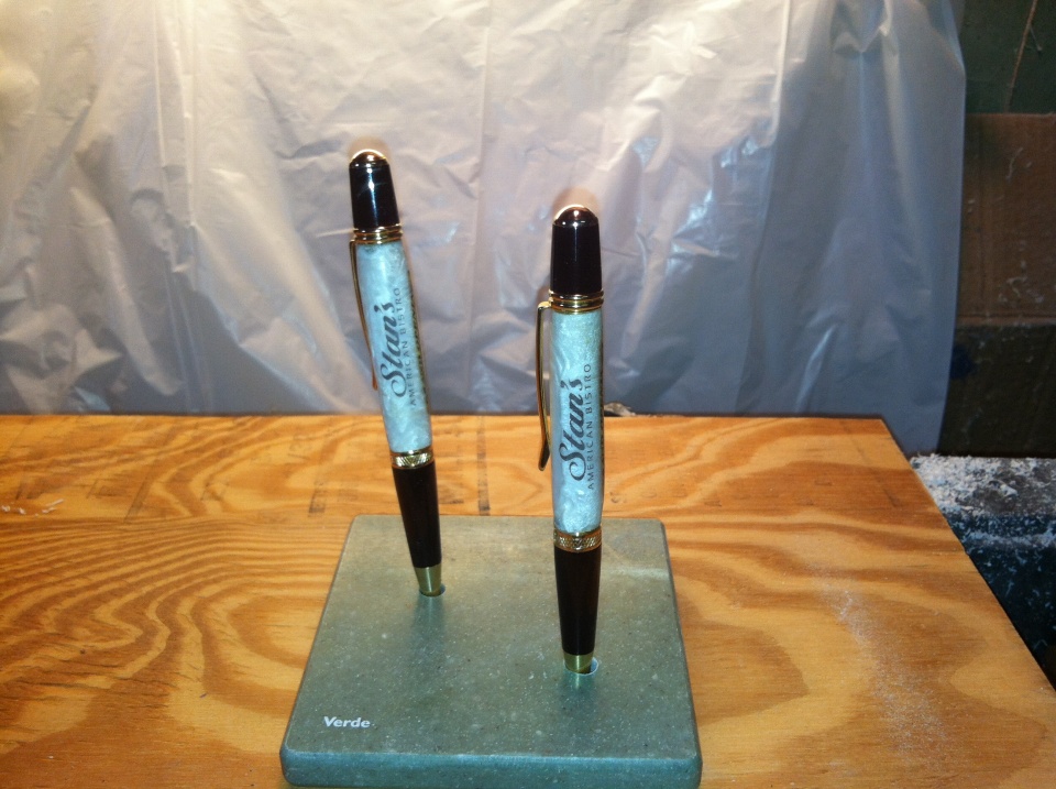

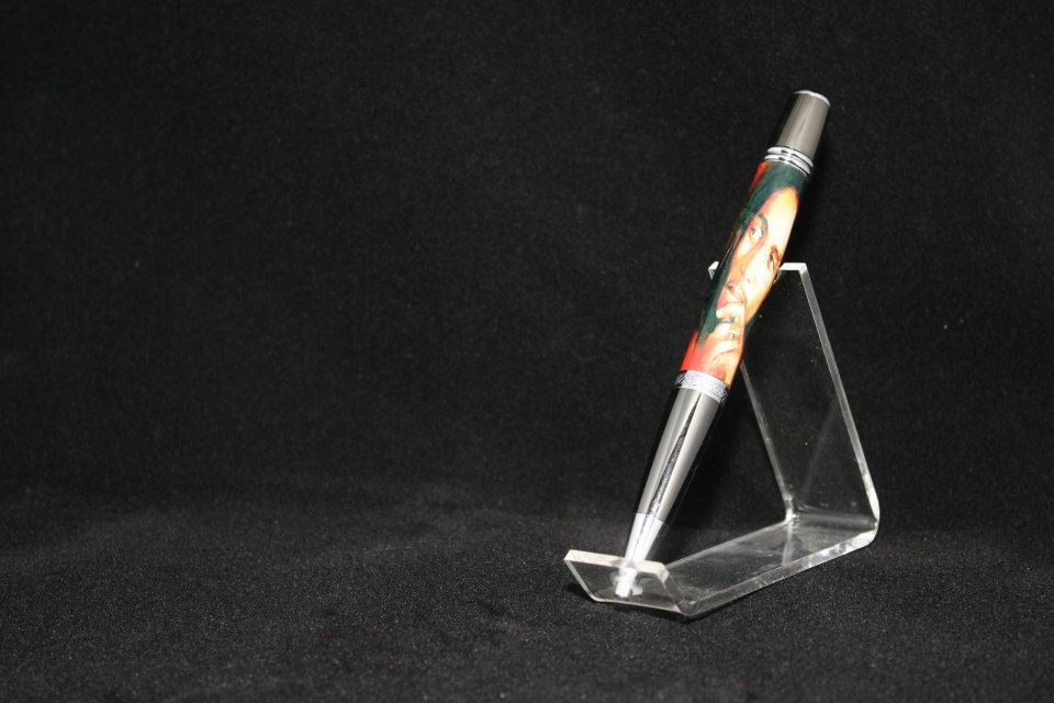

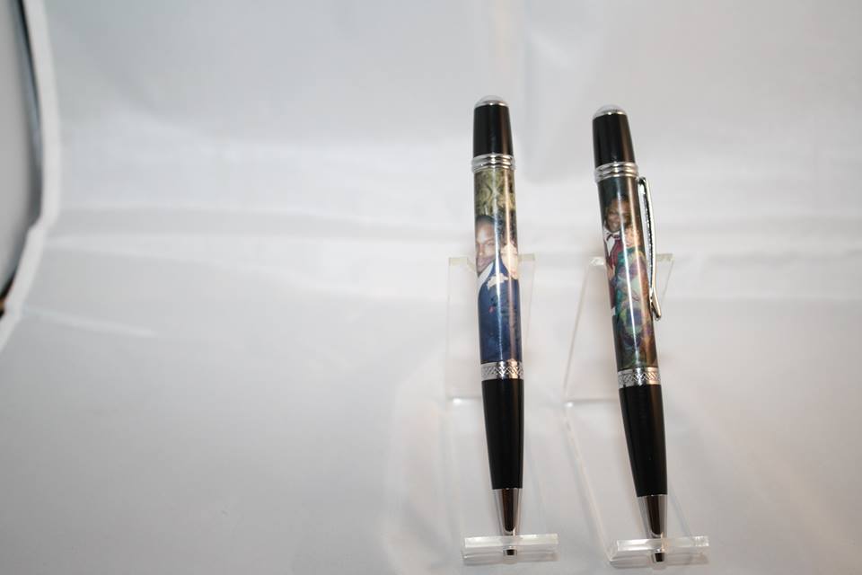

talking decals, has anyone ever tried a clear address label instead of a decal? just wondering if it would work, wouldn't have to worry about it not sticking.
I use the full sheet adress labels on a injet printer without any problems. I have attached photos.

I agree with the Krylon sealant before casting.
My challenge has always been hiding the seam ...
John - looks like you solved it, Can you share your process?
A good way to to hide the seam is try and make it part of the design or at least avoid a straight line. The eye picks up on a straight line...something to think about.

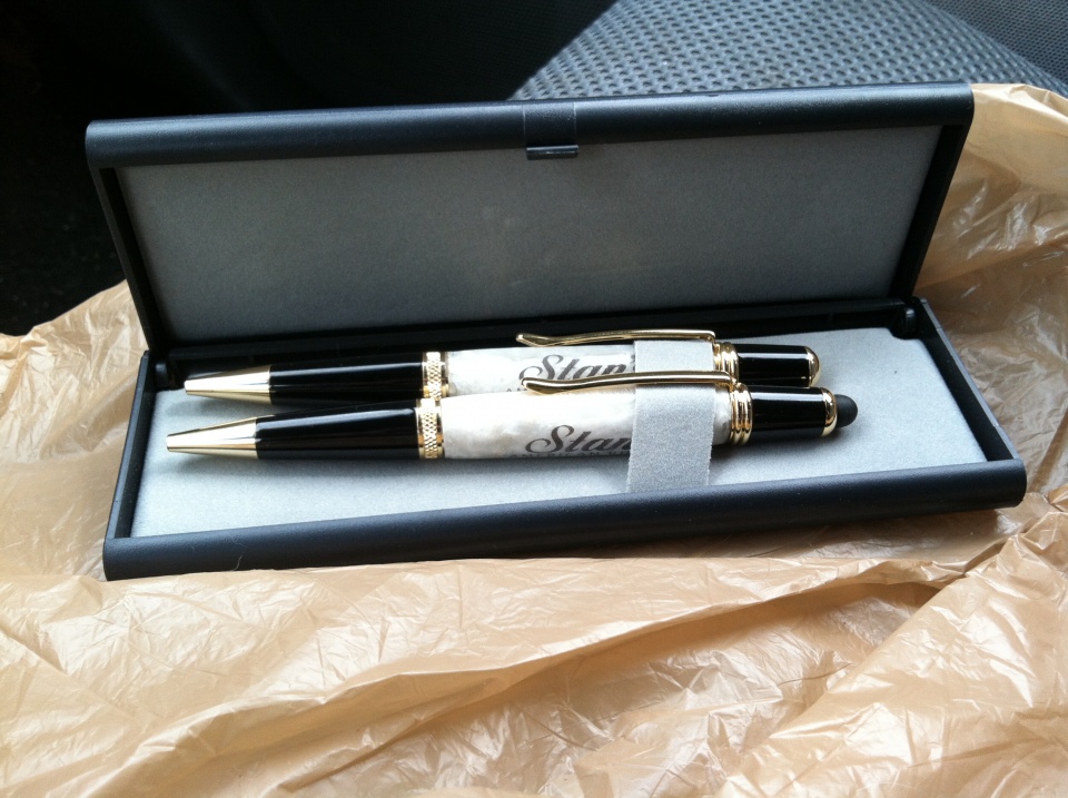

1. I spray paint the tube white.
2. I copy the picture into Power Point and resize it. H = 2.9" and W = 2.6,
these measurements are used as a starting point . I will tweak the image
if the image does not look proportional.
3. I use Avery clear full sheet labels from Office Depot to print the image on.
Since I use full label sheets, I print multiple images onto a sheet. I
average about 10 images per sheet. Note: I try to use an image with black
on the border to help hide the seam.
4. I usually let the ink dry for 24 hours since I am impatient. The longer the
ink has time to dry the less likely the ink will smear while you are trying to
adhere it to the tube. I noticed if there is a lot of black color in the
picture it needs to dry longer. This may just be my printer.
5. I trim the picture to fit the tube and perform test fits.
6. After the fit is to my liking, I adhere the image to the tube and then cast
it.
I used the clip to hide the seam.
labels: Avery Clear Inkjet Labels Full Sheet 8 12 x 11 Box Of 25 by Office Depot
