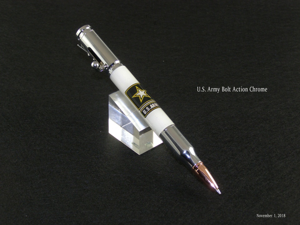

Did some casting last week and this is one that I did. I do not use a pressure pot, I pour PR in two stages. This method still gets bubbles some times, but I have about 90% success rate now.

Lovely pen, Ben !!

Multiple pour casts are done by several casters, especially with polyester resin. I know a guy who makes snakeskin blanks...about 50 at a time...and he casts in three layers instead of two. The process works and works well. NIce lookig blank on that bolt action, Ben. Thanks for sharing.
