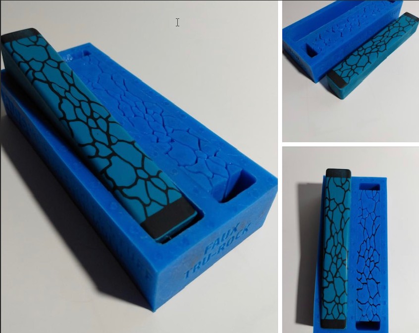

I seen these on a facebook. Found here, never used them or bought them, so can't vouch for any of it. https://armandswritestuff.company.site/

Yeah, I've watched a number of things from John U about how he handles resin. He always recommends waiting till certain temps.... That is partly why I asked the question, as I figure you really don't have much time once you get to that point, to inject another color and try and get it "vein-like" before the resin sets.
Its probably a pipe dream. Hopefully someone has had some knowledge about how veins like this are made. The think Ken linked, is interesting...however I suspect that once you turn, you would get some unusual results with the "long edge" of the veins...as based on what I can see, the cuts for the veins extend strait down to the bottom of that part of the mold. Kind of like what you might get with laminated or plywood blanks...the edges of the layers look great from one angle, but they spread out 90 degrees from there.

I wonder if you cut the first molding in half and turned them 90 degrees in the second mold, would that work?? Might have a hard time getting the resin in there though.
