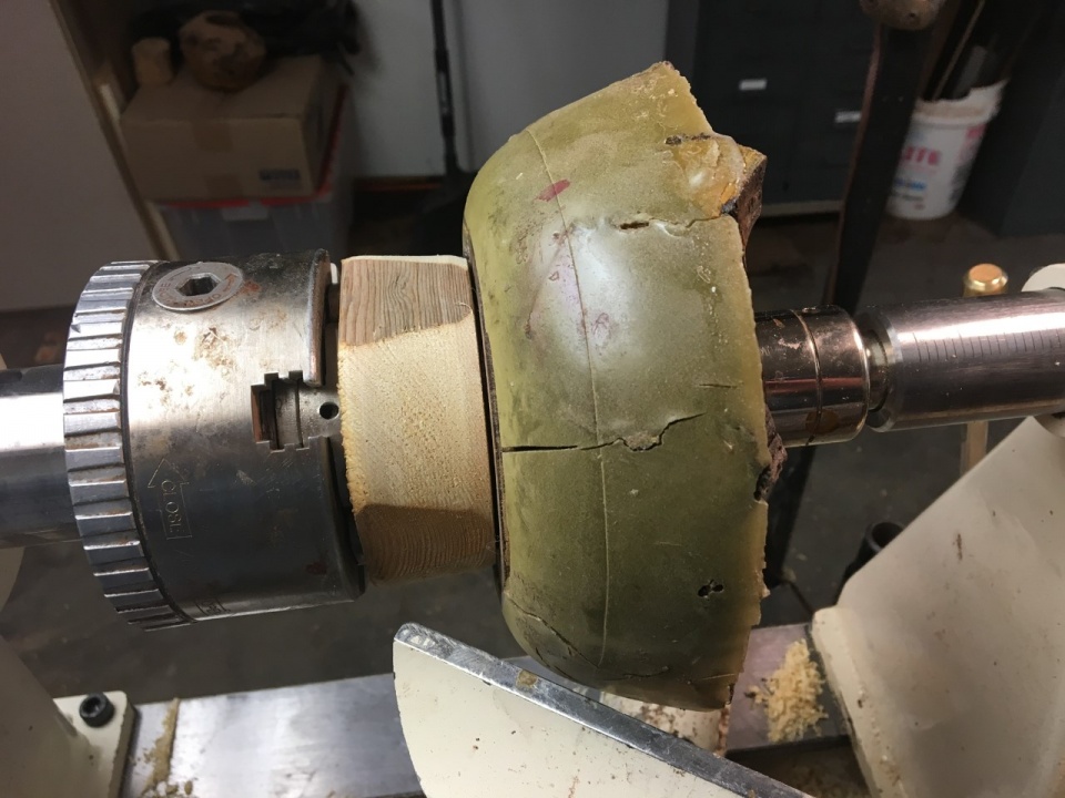

I tried to cast some wood pieces for a bowl using similar 41. I mixed the resin according to directions and added some brass powder (approx. 1 1/2 teaspoons to 2 cups of resin). The resin turned emerald green and had cracks in between the wood.
Could this be a chemical reaction between the brass and the resin? I cast some colored pencils in that resin last week and no problem so I don't think it is the resin. Any ideas what caused the color change and cracks?

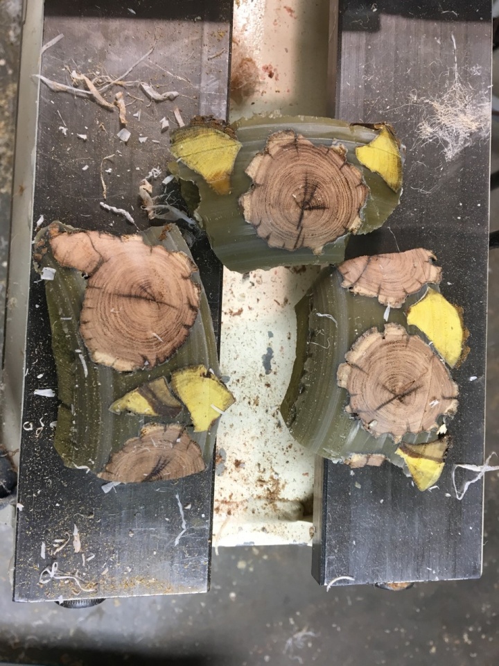

I got the pictures to load. You can see the cracks and that it broke while I turned it.

Wrong resin for that type of work, or you have to reduce the hardener to 1/4 of the recommended amount and be willing to wait a few days for it to set.
Any of the based Polyester type resins that cure at extremely hot temperatures is not a good choice for blanks that require a fair amount of resin, it will crack every time, even if the wood or whatever you embedded in that resin is humidity free, therefore properly dry or even stabilised.
You have at least, 2 issues with that blank, the wrong type of resin and a reaction to the brass powder you used.

Pour the mold partially full and let it set till it cools a bit ... then add your wood and pour till the wood barely starts to float (add your internal mold to hold wood in place and weight it down), and let it set some more till it cools again ... continue pouring in stages till your mold is full or as full as it needs to be.
Once the final pour is made, you may want to keep your casting in a hotbox to allow the entire molding to cool off slowly and gradually... this need will vary from one resin to another.
Using a resin or epoxy that has very little shrinkage will be an essential item for large pours that contain things that will have little to no expansion/contraction from the heat.
If your wood had water content in it, that may be the source of your adverse reaction with the brass powder creating the green color.
