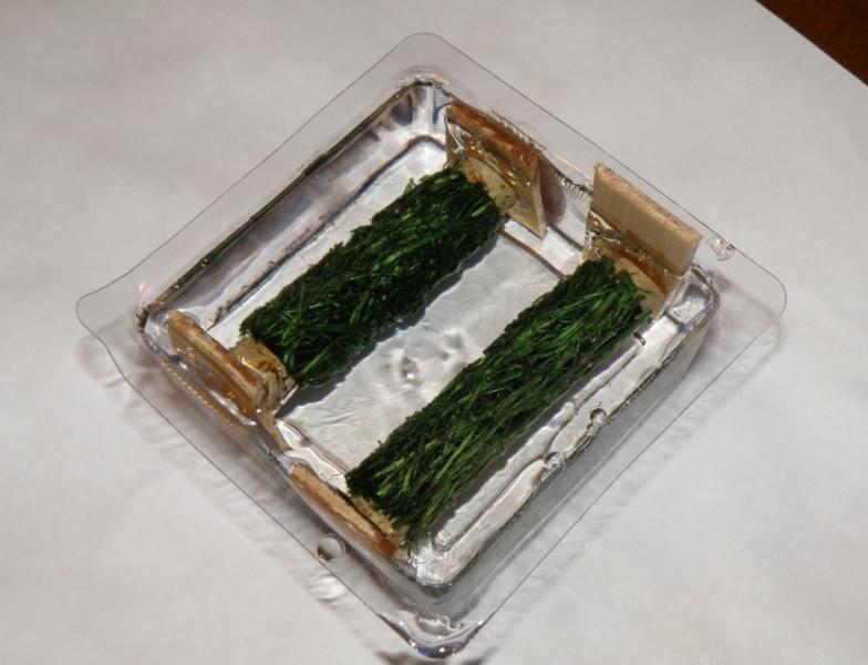

I found some fake grass at Michael's and am trying it out. Haven't dealt with PR before so we shall see if I learned from the tutorials. I had some left over so I threw in some grass from the yard to see what would happen.

Trying this out. Picked up some PR from Michael's (good thing I had a coupon cause that's expensive!) and here's what I've got so far. Hope I'm on the right track. I'm doing this more for my learning than his pen, but if it works...great!

Looks great for a first casting attempt. Nice green color too. Should make some
cool pens. The shorter barrel looks pretty thick. Take care not to turn too deep!

Looked at it this morning. Seeing some bubbles of air trapped on the underside. Anything that can be done about this? Or just turn it down to those points and fill with CA?

I would say it depends on the size of the bubbles. I would not fill any large voids with CA because it has a potential for turning white and crystally. I'd personally use clear inlace to fill the voids, but you could mix up a small amount of PR with a few drops of Catalyst and wipe that into the holes, wrap the pen with some masking tape so the PR can't leave the holes, then bake in the oven on low. This all being done with the pen just a smidge overturned, so you can re-spin it once repaires are finished.
the fake grass was a good idea. Drying grass, even if it stays green, can turn ugly brown from the heat of the casting process. Of course, dying dryed grass was a good idea though, as that would counter act the cooking problem I think.

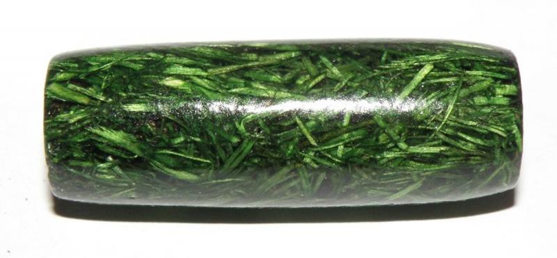

Still in process, but looking good
I've gotten one of the tubes turned. There were some voids due to the grass being too thick around the tubes, but I was able to fill with thick CA and it has come out nice a clear. A few bubbles have hung onto the grass, which I will just tell him it my intention to show it as a freshly watered lawn :biggrin: It has not been sanded and finished yet, but I'm happy with it.

Eric that turned out very well! I like the looks of the grass material. It looks real! Im sure your customer will love it and probably want more. My advice for casting... after you pour the pr over the blanks, brush them with a tooth pick to force the bubbles out. Then put under pressure. If theres any small bubbles left in the end, you can always try to cover the larger ones with the clip. Nice pen, looking forward to seeing the finished product.
