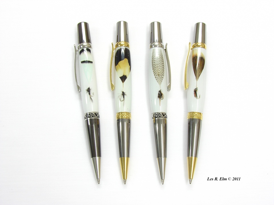

Another idea to consider is wrapping the tube with rod making tread as opposed to carbon fiber. Plenty of colors available and a lot thinner. May open up the kit possibilities.
I found that the Sierra series work best with the thick walls.
Les
