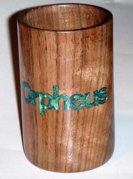

I use it all the time; usually 30 minute Devcon with either powered pigments or liquid Mixol. Occasionally get a void, but can usually patch. Here's a pen cup I did recently with filled Logo. Let it sit overnight is good advice.

Pigmented epoxy rocks! I LOVE the System Three product line. It's hard to find, but really great stuff. They even have their own liquid pigments (which I found to be better then the powders) which work quite well.
I've never tried doing the "pearl" like Bruce's cup above, but after seeing it, I will definitely give that a go.
Sorry to thread jack, but where did you pick up that perl Bruce?
