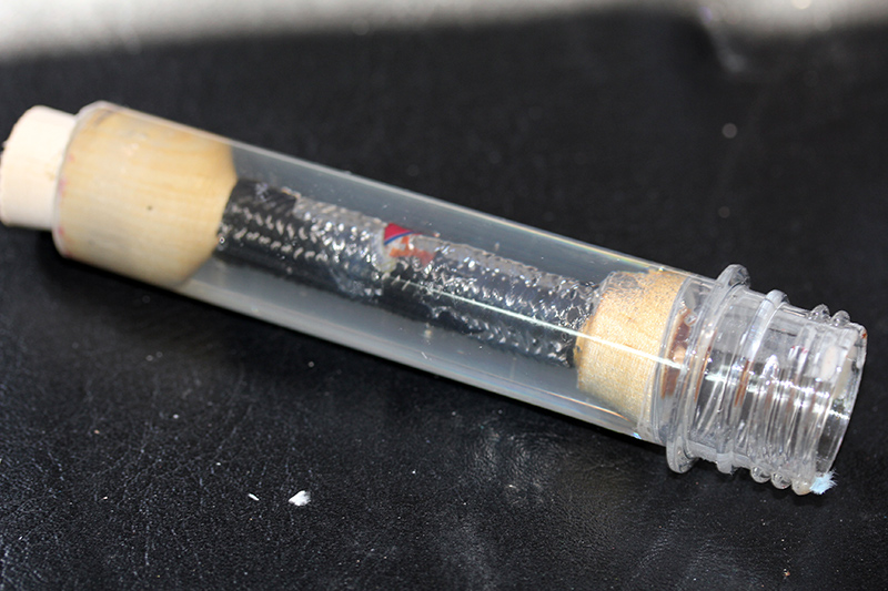

Had another failure using PR. PR is picky about weather conditions. I am assuming a rainy humid day had impact on the very slow curing but the bigger deal is the molds I used with small plugs allowed PR into the tubes. :frown: I thought I pushed the plugs in firmly but obviously not. I believe I'm going to experiment with alumilite. It cures faster and I think is less dependent on perfect weather conditions ( temp and moisture in the air). I hope to have success soon.
I just saw the picture of your mold. Most of the time I check the website on my company computer and I guess they have something set to block things other than sex and weapons. Anyway that is an odd mold. Not trying to force you to go a certain way but maybe give you other things to think about while you decide how to try different things. I've been using silicone plugs with plastic tubing to make my vertical molds. Things were going good then I had a few failures that really disappointed me. I started thinking about the people that use the horizontal molds for basically the same things I do so I did a few things differently with the same molds I've been using and laid them on their side. I used both with and without a pressure pot and so far I've had good results without using pressure. My molds now have a gap along the top like the silicone block molds you see for casting pens and I think the mold being horizontal gives the air a shorter distance to travel to escape. I think it also allows the Pr room to shrink without pulling away from the tube. I just started this Friday so it maybe beginners luck. You're correct about the weather conditions that can play a big part as well. Good Luck
The second failure used a different mold than what was pictured. I used a silicon mold with associated plugs. I think I did not push the plugs firm enough. I will get success. I'm a little too stubborn to let it beat me, right now anyway. I currently have some alumilite under pressure on some fiberglass blanks. Fingers are crossed.

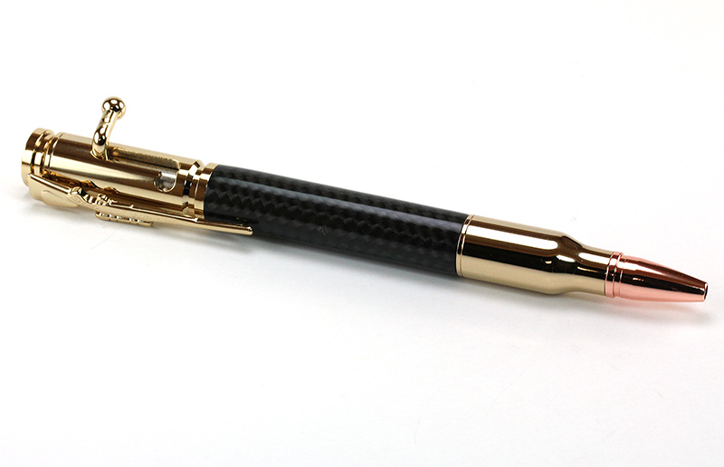

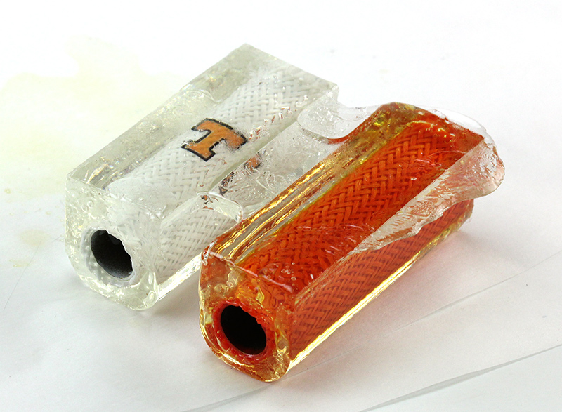

I thought I had a good cast with alumilite on glass fiber. The blank showed no bubbles or separation. But, put the blank To be turned between centers and as soon as I put a little pressure on the bushings it began to separate. I think I'm going to have to wait for better weather and go back to trying PR. I also tried a Carbon fiber with a label. Built up the CA over the label. Sanded it down to smooth. Cast with alumilite and it too separated. I'm using 65 PSI for 2 hrs on both castings. I'll continue to experiment. I've read a thread from the past that someone suggested spraying the blank with lacquer and someone said polyurethane before casting with alumilite. Wonder if one of those methods worked?
Mike I've never TBC but it sounds like the pressure might have caused the brass to flex and that caused the separation of the alumilite. Whenever turning resins you can't put any pressure on the resin just the brass tube. I use bushings and a barrel trimmer and make sure the ends are clean before mounting them on the lathe. It should be the same with wood or other materials it's just that they are more forgiving. As far as the one coated with ca did you let it set for a few days to out gas? Some wait 2-3 days I wait a week. It sounds like your close just don't want you to think the failure is the cast when it might be something else therefore it's takes longer to figure it out. Also I'm no expert I'm just giving you some of the experiences I've had in the past.
Thank goodness each failure gets me a little closer to agood product. What I learned this time is to pay attention to the room givenbetween the brass tube and outside diameter of the pen barrel. The glass fiberdid not have enough room on the nib end of the cigar pen blank on the UT pen(orange and White). When I turned it to size the white fiber was exposed.Besides that, there was still separation that did not look good on the whiteand orange. This was PR under pressure using modge podge for sealing the label.Still have a learning curve on casting resin on fiber. The bullet pen is almostperfect. However, I left a fiber sticking up that I didn't notice until Istarted polishing. Also, the room on the blank did not warrant resin so I justbuilt the blank to size using CA. My hat is off to all those that have beensuccessful at making carbon fiber blanks. I'm getting there but I think I mustbe a slow learner. :confused:

Pictures make all the difference. The problem is obvious. It's the T with the orange color. It should be an aTm with maroon. No just kidding. It's like you said you learn by trial and error. Of course it helps by learning by others mistakes and findings as well. Let us know if you find the magic solution and we'll do the same. Thanks and Good Luck

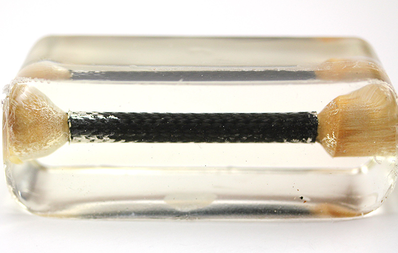

I am at failure four or five. Losing track. I have varied many things. This time was without a label so obviously no trapped air under the label to blame. I have used both alumilite and PR. This is alumilite. The only other variable I can think of changing is how I seal the tube ends. Since the air (or separation) seems to be at the ends, I wonder if air is escaping from inside the tube? I am using 60 PSI in a pressure pot. Those are just wooden dowels turned down to size with a sllight taper and then pushed in pretty tight. These are 7mm tubes I have been attempting. Any advice?

Go for silicone plugs! If you are using pressure, it will PUSH IN the plugs tighter. Vacuum will pull the plugs out and suck the resin in.
You have done tube on casting and use the silicone? By your advice do you also think it could be air from in the tube? I certainly will give the advice a try. Nothing else is working.

The wooden dowels are porous. When you pressurize the cast you might be forcing out the air in the plugs into the cast.Silicone plugs would sure be worth the money to eliminate that problem. Also it looks similar to some of my failures which I thought was caused by the resin shrinking away from the tube sticking to the mold. I now use a good mold release and it helped with that problem.
Thanks for the input. It seems alumilite should not have separation issues since the characteristic belongs to PR, I think. I won't give up yet but the alumilite corporation must like my failures because I have to order some more. Air from porous wood makes since. I will switch to rubber/silicon plugs.
