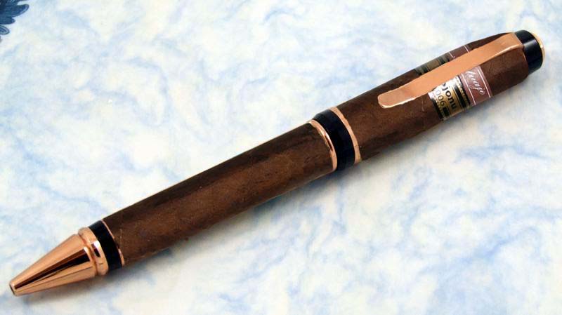

This is work still in progress. A friend asked me about modeling a cigar that his son smokes. I worked on this off and on for several weeks. I still don't have all the bugs worked out but getting closer.
My first problem was the label. These cigars are expensive up to $50.00 each. I only had one label and it was a little big. So I had to reproduce the label literally redraw the font. I have an Alps printer so I was able to reproduce the gold foil. I happen to live near cigar shops and was able to talk them into giving me some tobacco leaves.
I went about this like a snake skin. Wrapping the tube and casting not as easy as it sounds. After many failures I still don't have all the bugs worked out. I am still getting some dark areas from wetting. Last try I used color preserver they use in fishing rod building to stop the resin from wetting the thread and making it dark. It worked pretty good but I still got wet spots. Maybe another coat will do the trick. Boy casting bugs take a lot of time to work out.
Oh the pen kit is a Gentelmans kit.
Bruce

Originally posted by Mather323
What was the name of your color preserver that you used?
I used U-40 color Lock 2. Igot the ides from my fishing rod building days. Some resin still got past it that is the dark spots the [picture hides the bad spots. The resin soaks into the skin and wets it. The same problem the label casters have with wetting paper. I have a few more ideas. But this takes a lot of time and gets exspenive exsperimenting.
I don't really think stabizing an actual cigar would work. I can see lots of problems. I have a lot of ideas but boy the development process takes forever.
Thanks
Bruce
