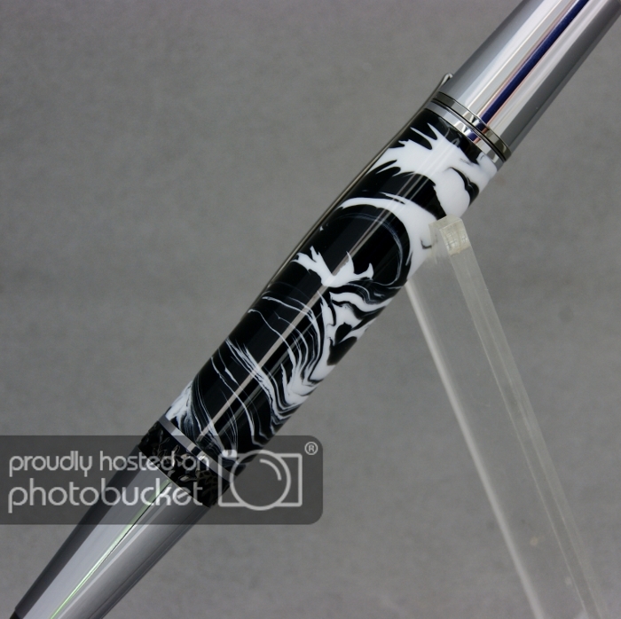

Here's a pic of the colors. I think you're wanting them in seperate blanks but this gives you an idea of opaquness and finish:

Thanks Jonothon. That is exactly what I want. Nice pen by the way. Will give the suggestions a look see. When you say US Composites, are you talking their powdercoating material??? If so don't they have a black too???
