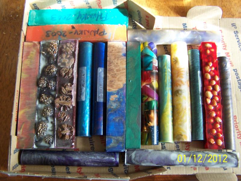

got the box in mail today. pic attached. i know o am taking the texas dollar blank, i am a cigar pen nut anyway, but will figure out what else later .
will put back in mail when i know who to send to.

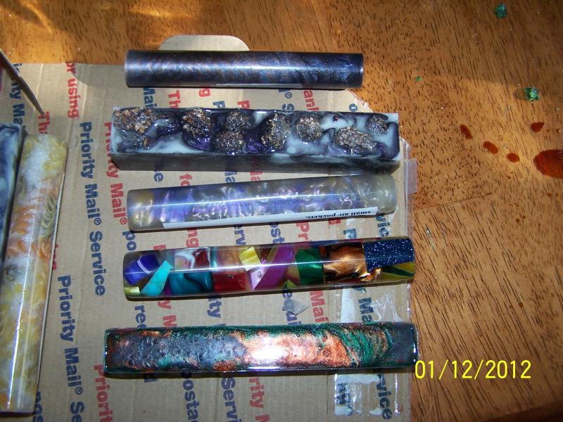

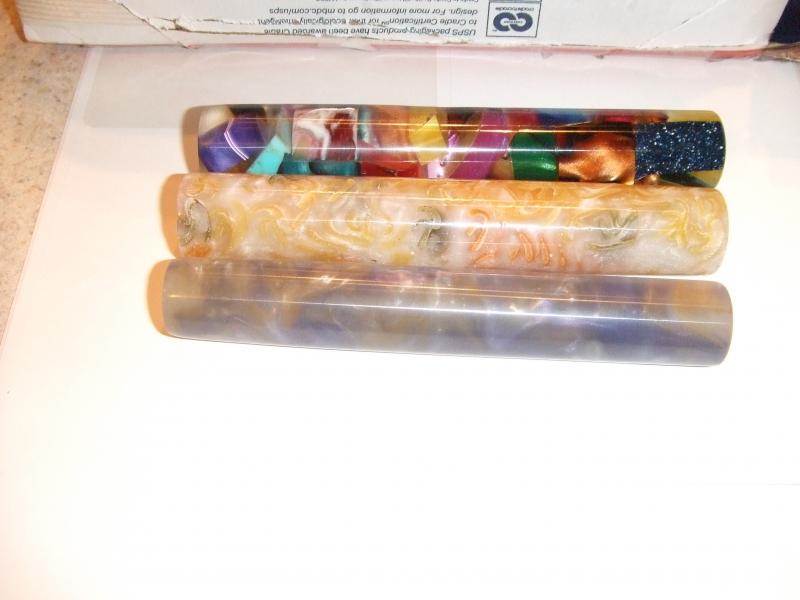

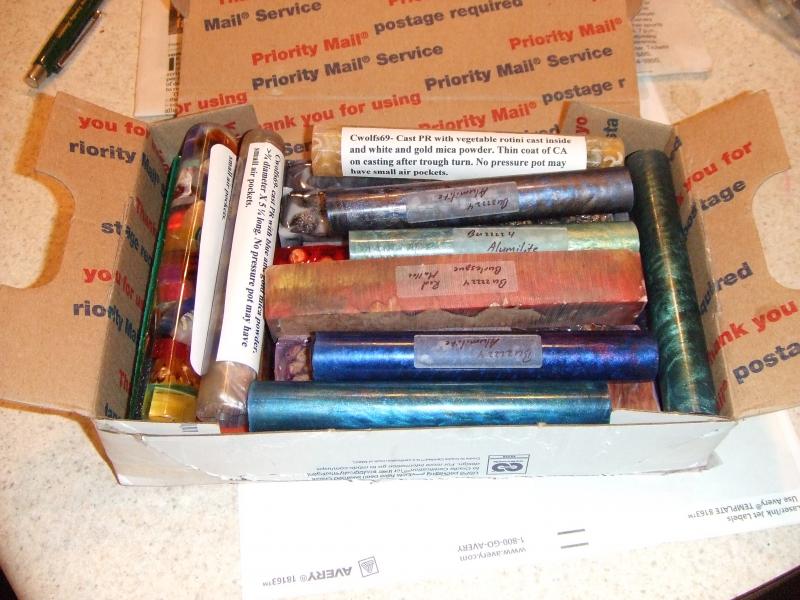

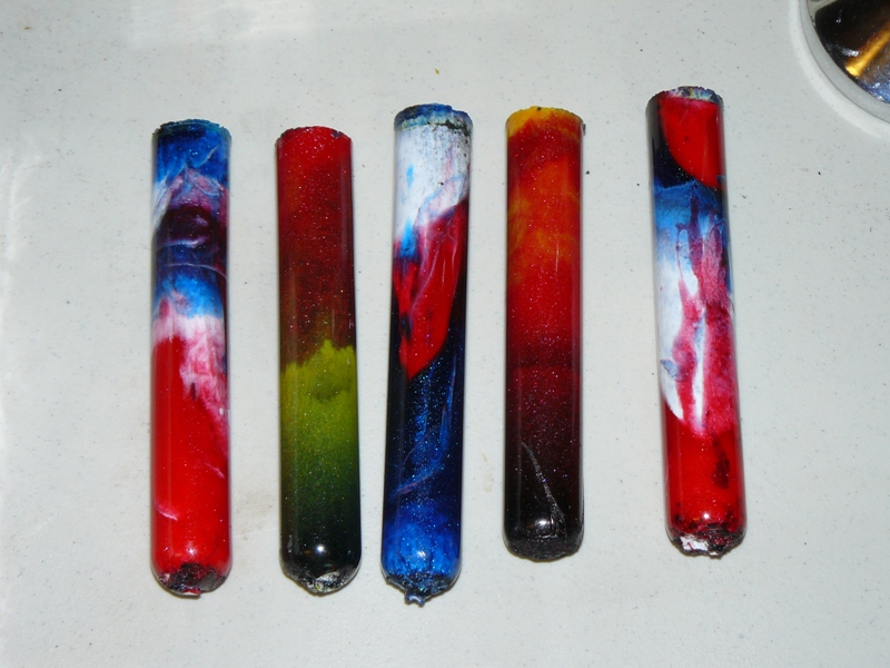

well i have taken, replaced and ready for box to go to the next on list. i will be giving the box directly mike, NAVYCOP, at his house in the morning. below are pictures of before and after at my place. the pictures are almost in reverse order. the first is of the three blanks i took out, the second is of the three blanks i put in, the third is of the box as i closed it ready to go to mike in the morning, and the last is of the box the way i received it.

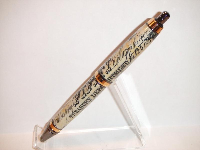

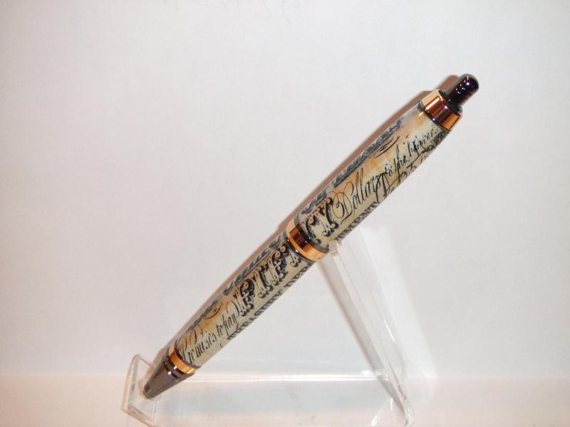

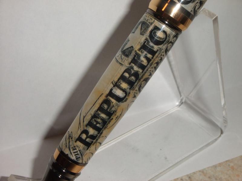

first complete pen.

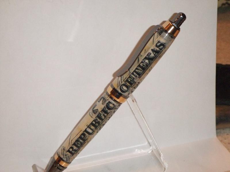

well here is the first pen from this castaway box trip. this is the first one i chose from the box. i had to have this one as soon as i opened the box and saw it. i had actually been looking at some almost the same to purchase previously. had no choice on pen style due to blank already haveing been cast as cigar blanks. but i did choose the click style for 3 reasons. it is one of my personal favorites, i thought the color scheme would look good on the blanks, and since it is a click the alignment will stay together which can be a problem with twists. i am pretty sure that this was alumalite. turned like a dream. no problems with turning and polishing. turned, sanded with 320 and 600 grit, wet. then MM thru 12000, wet, and Hut Ultra Gloss.
Here are a couple of shots of the whole pen.
texas whole.jpg texas whole 2.jpg texas whole 3.jpg texas fifty.jpg texas whole 4.jpg

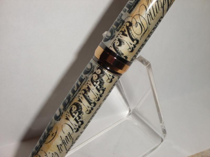

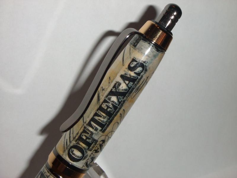

now some close ups of the top and bottom

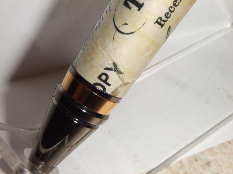

I did get a crack when pressing the nib section into the pen and had to remove and repair with CA. the close up here looks much worse than the actual pen does in person.
enjoy pics, comments good and bad will be greatly appreciated.
If you pm me your address I will send a replacement.
Thats a beautiful pen! I make the blanks and it never crossed my mind to put one on the click version. I really like the looks of it.

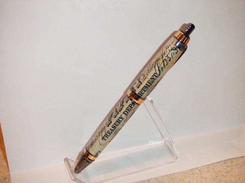

Well here is the pen for the second blank i took from the box. I wanted a pen that would leave some meat on the tube after turning. The civil War pen is good for that. Besides, i thought the color combination would look good as well. I think it turned out pretty good. Comments and criticism please.
Thanks Buzzzz4, blank turned great. Only tiny holes showed up during the turning and polishing. I believe they were all inside the cones and easily filled.
The wife really drooled when she saw it last night.

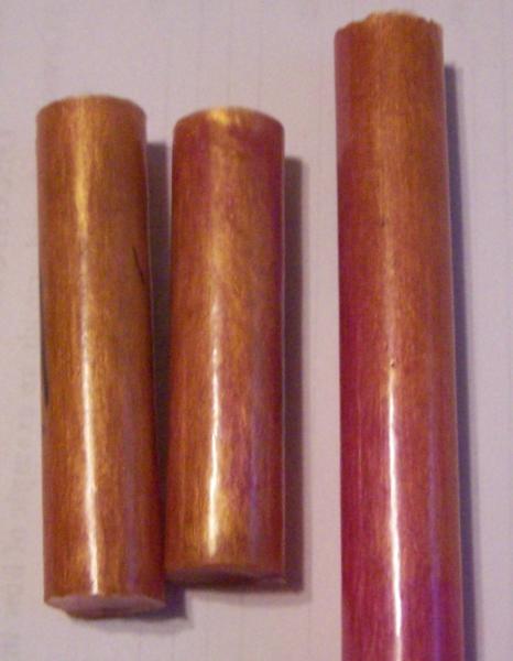

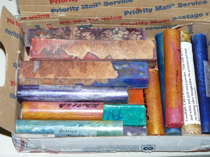

The box is on it's way to Marlin, TX (maybe not yet-just dropped it at the postoffice. The misses didn't get a tracking number but it is going to Texas 76661. FOI it weights 1lb. 15.50 oz.

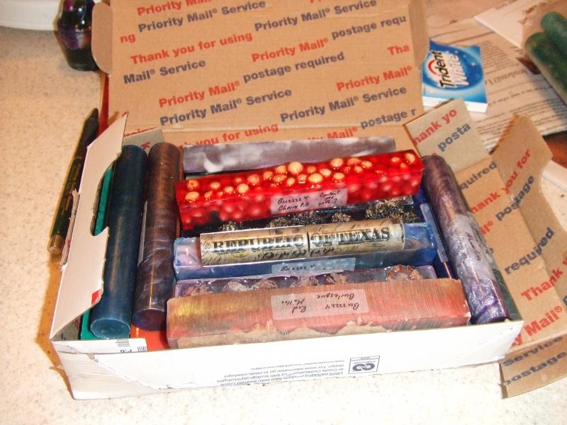

Just got a moment to load pictures.
First picture of course is the box.
Second is what I took.
Thrid is what I put in.

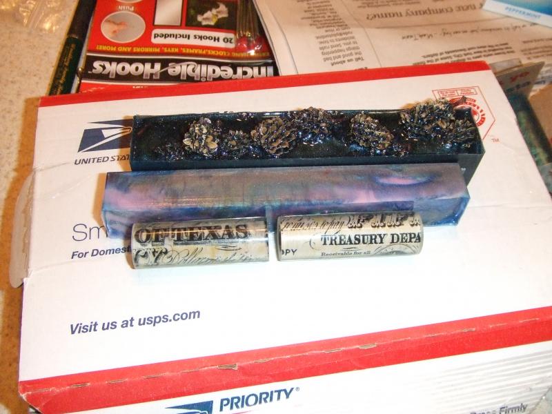

Castaway Box IV is in the house!

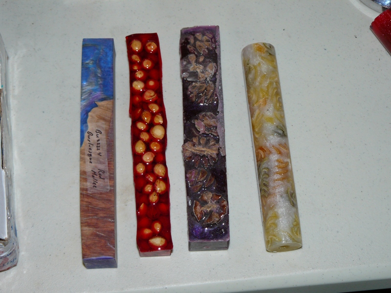

Received the box yesterday(Thursday).

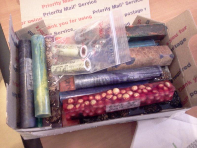

First picture is how it came in, second is what I took out(4), and third is what I put in(5).

Looking good. Have fun with those Cherry pits. Let me know if you have questions.
