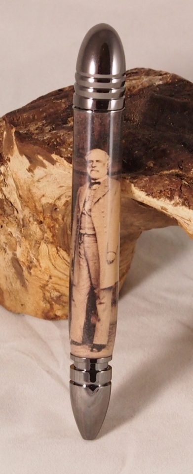

I am not sure if this gets to your question or not. When casting photographs, I print the photo on an avery mailing label, attach the label to the tube and spray with clearcote acrylic sealer. That has worked well for me. Here is a Robert E Lee pen that I made using this technique.

Cwalker935: Love the Robert E Lee pen! That's the results I am looking for so apparently doing something wrong.
