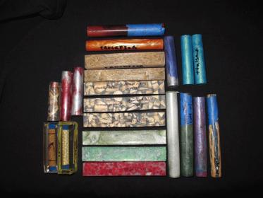

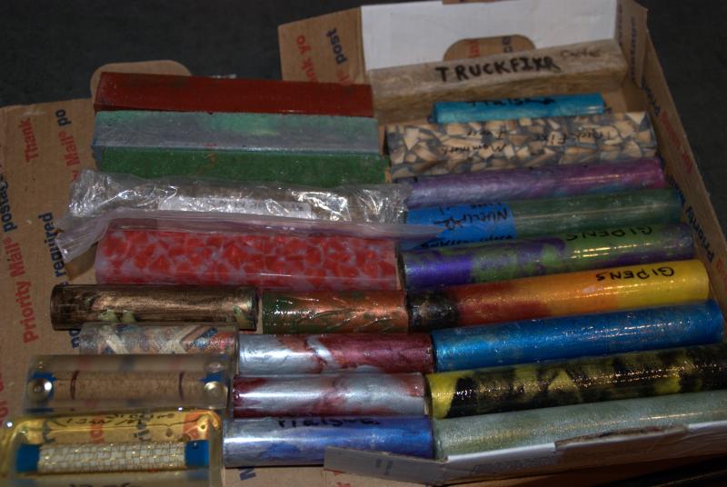

Ok, I cast a few mammoth ivory blanks and added them to the mix. Here's the revised outgoing box
Outgoing 2_604x453.jpgcontents

The blanks I made for the first swap were pre-ban elephant ivory. These are mammoth. I thought the elephant ivory smells bad when you cut it. This stuff makes regular ivory smell like daisys. Whoever ends up with them, I'd like to offer a little advice. I've found that PR doesn't get a really strong bond to ivory, so very sharp tools and very light cuts are important. I destroyed my first blank by drilling it too fast. If you notice any seperation of ivory from the resin, just glue it up with CA and let it cure. It's a good idea to put a good CA finish on it to seal the ivory .

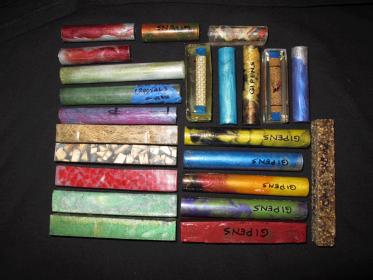

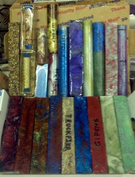

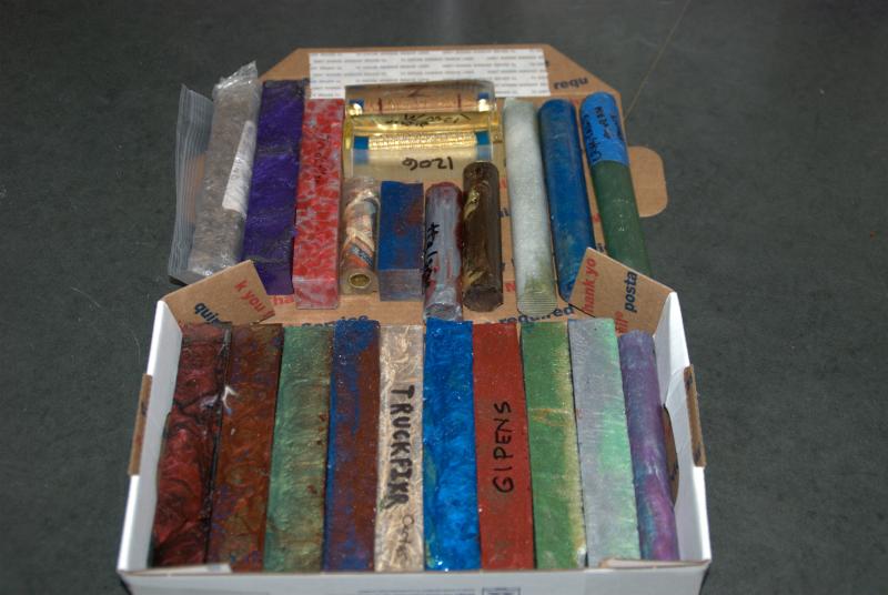

Well, here is the box as it arrived - and the box before it left. Now, I just need to know to whom it shall go!

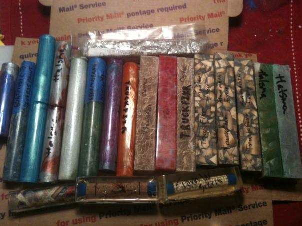

Got the box today

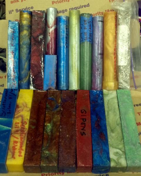

Got the box today in the mail. Here is the before and after pics will post the tracking number monday as soon as I get back from the post office. Thanks again! The box was great when I got it. We have plenty of great casters here!

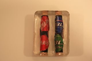

Jonathan,

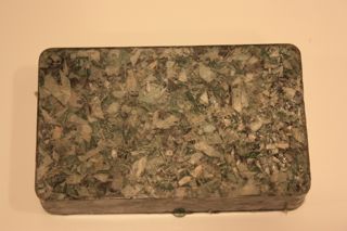

My casts specifically made for this trade were 50/50 :frown:
I made a brick of shredded money blanks, which should yield 3 blanks. It appears to have come out fine.

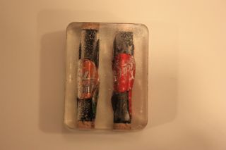

I also tried to make 2 bottle cap blanks (for Sierra Vista), one with bottle caps from the Coke with real sugar (imported from Mexico). The 2nd was 3 Bud Light (BL) caps, one green (lime), one blue (regular) and one orange (wheat). I have made bottle cap blanks before, but this time I chose to use the Barry Gross method of 3 individual pours. It looks like I may have rushed (didn't' add extra cure time due to the cold) the 2nd pour, because when I put in the tubes, the bottom pour was not solid, and I could feel the resin move beneath the tunes. At this point I assumed the new resin for pour 2 would just fill in where I pressed in with the tube, as you can see in the pictures, this was not the case. :mad: And they looked so nice from the top too.
You can have them if you want them, let me know, otherwise, into the garbage.

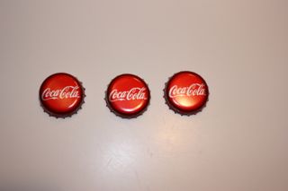

I will include 3 of the Coca-Cola de Mexico caps so you make one yourself if you choose.
I will have my wife ship out the box Tuesday as I promised I'd have it back to you before the holidays. Once I get a chance to cast the caps again, I will send you a couple.
Sorry for the delay. I've been wanting to make these since the fall, but my two sons baseball and football took most of my time.
Lou
