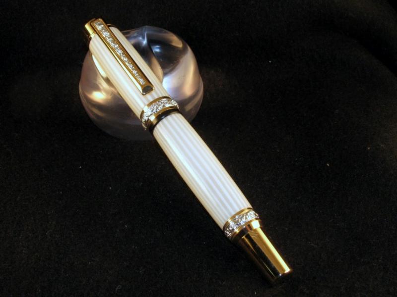

NOPE---New Alternative Casein:
Turns and drills like a cross between acrylic and alt ivory. Not as dense and hard as acrylic, but not as "powdery" as alt ivory.
Pretty good likeness, though.
All comments encouraged--even bad ones!!!
Thanks

Erik,
YES, and no. The piece I used I did not drill carefully, just drilled. Stick around, picture coming--I can't describe this properly,

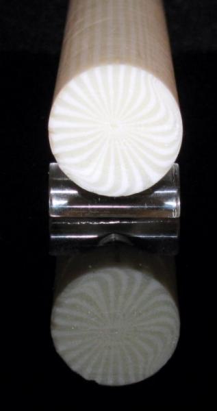

Ok, Dawn was using the black glass so I left it there. The reflection may help more than the actual straight on shot.
The lines are straighter than casein--more regular.
They are very well spaced, near the center of the blank, but as they hit the outside diameter, the machine seems to create a swirl of sorts.
So, for small diameters, drilled dead center, it would be FANTASTIC. At some point (looks like about half an inch) the pen would near perfection.
As this sells, I am sure we will see people making the effort to hit dead center---
Hope the pic helps.

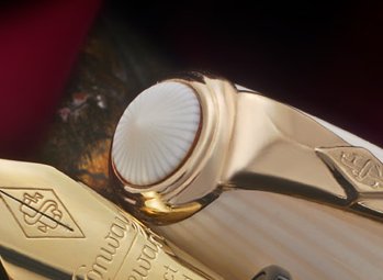

Okay, from that picture it does appear that they have gotten the radial symmetry of the real casein, so one could, for example, get this finial effect ...
... and get better regularity of the longitudinal lines to boot, as long as we lose enough of the raw blank's outer diameter.
Nice.

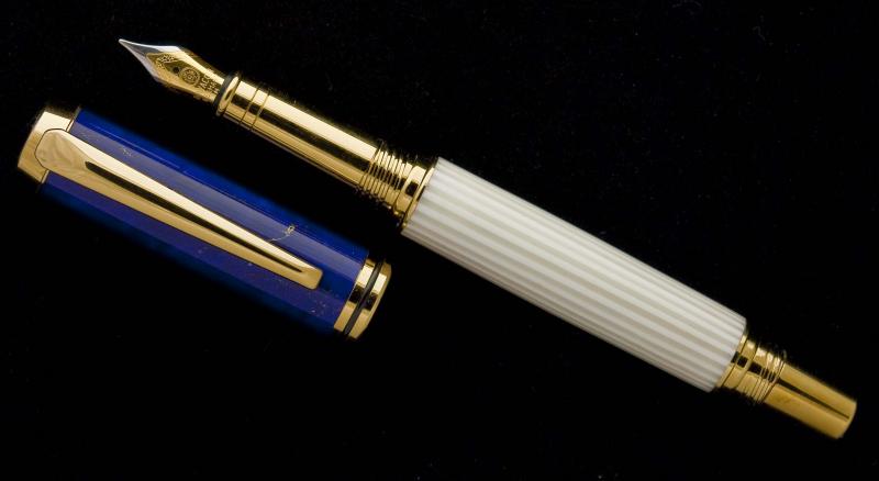

Ed,
This reply is just to support your observations. You and Dawn sent me one of the alternative casein blanks along with a recent order. I've attached a picture of a pen recently posted where just the body of the pen was made out of the alternative casein. The qualities of alternative casein with the core lines radiating outwards and the parallel lines on the surface appear identical. Moreover, the alternative version is somewhat more symmetrical and consistent when compared to the actual casein. From working with it, would seem easier to make a finial from it rather than the real casein. I found it to have the same properties drilling and turning as you did. My two cents worth....Doc
