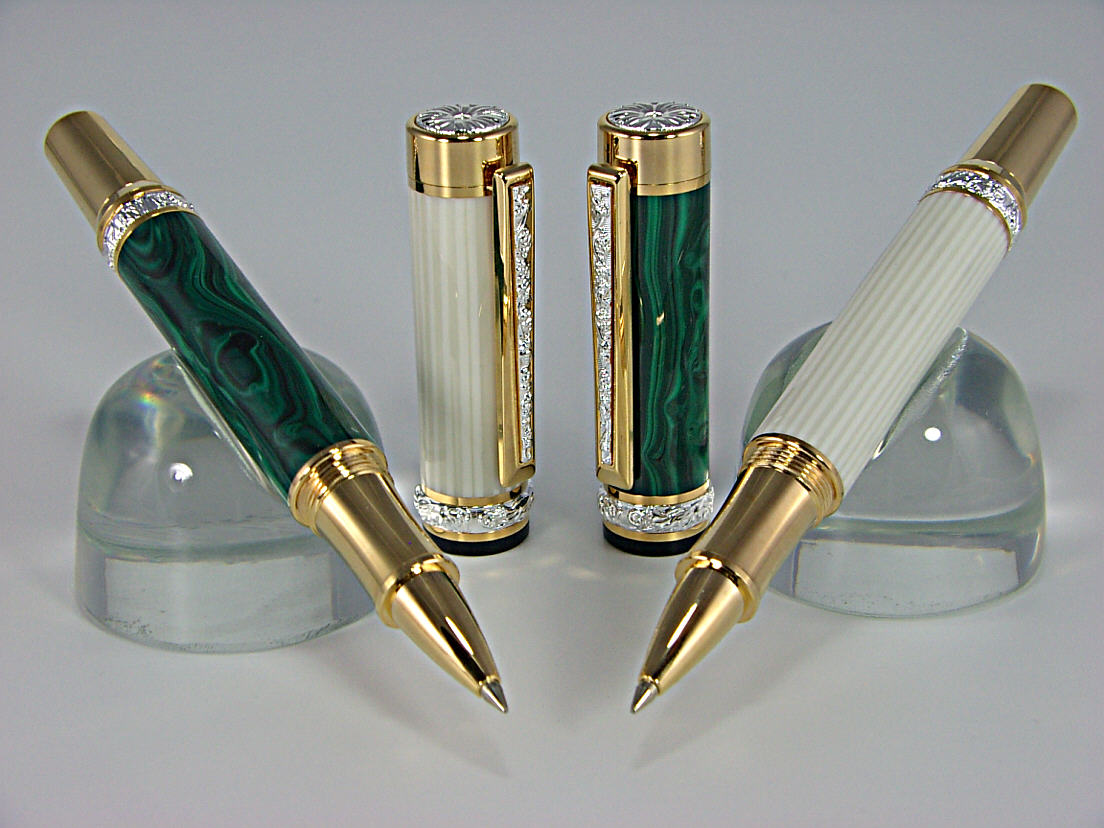

Now compare Docs original material to the imitation that I used in this pen. (white one)
