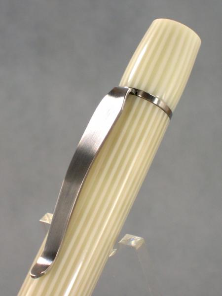

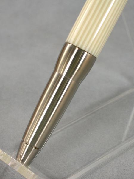

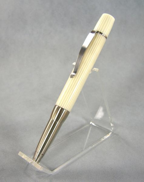

Here is a pen I turned this afternoon. It is a Marksman Falcon with an alternative casein blank. Instead of the usual Falcon cap, I turned a cap out of casein.

Thanks for looking!

Not at all. I had a tube in the shop that fit tightly over the twist piece on the mechanism. Ok, we all get lucky sometimes. I cut about a 3/8" length of that and drilled a hole in the blank, "O" size, I believe, to the proper depth. Then I used a 3/8" drill to countersink so that the mechanism would recess into the cap. Glued the tube and turned it down to size and shape. I mic'ed the size since I didn't feel like turning down a bushing. Then polished the OD before parting the piece off. Then after parting it off, I hand sanded down the end and polished it by hand. The kitless guys probably have more advanced ways of doing that but hand polishing worked for me. That's about it.

I did not paint the tube or the blank. It looks good but in the right (or wrong) light you can barely see a slight variation in the color. Probably going to reverse paint the blank next time.

I love it - don't know that I'm ready to try that material yet but its on my watch list.
Alternate casein is turner-friendly! Try it.
Regular casein is more finicky--careful in "facing" the blanks, especially. The slightest imperfection can result in a crack, much later in the life of the pen.
Great looking pen, MARK!!! The finial really finishes it off!
