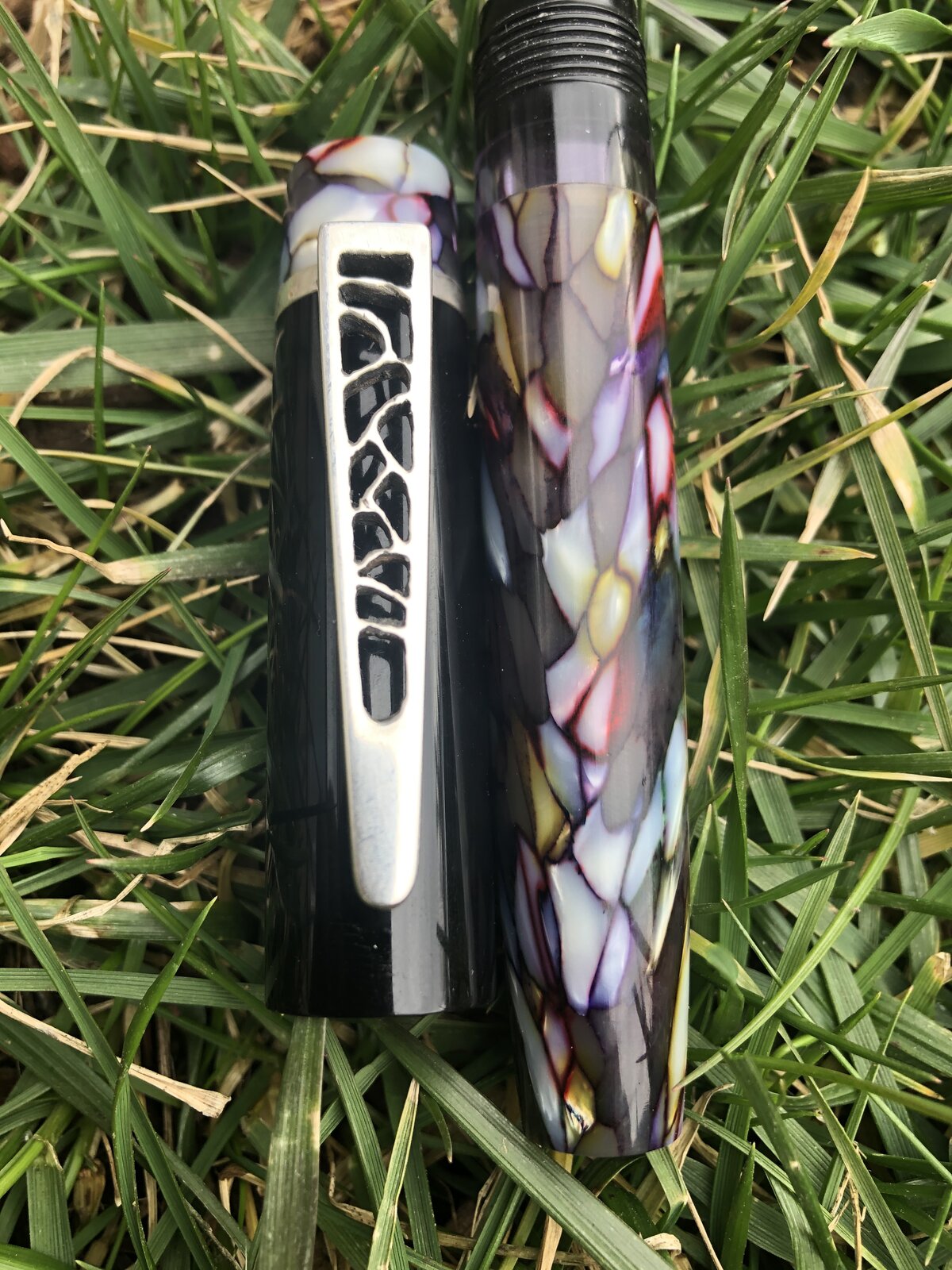

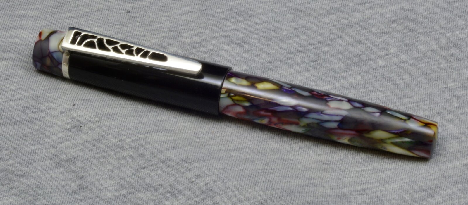

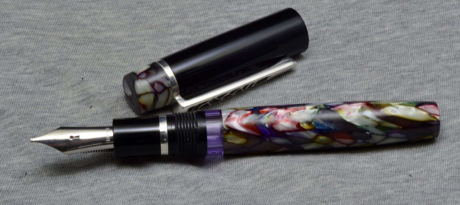

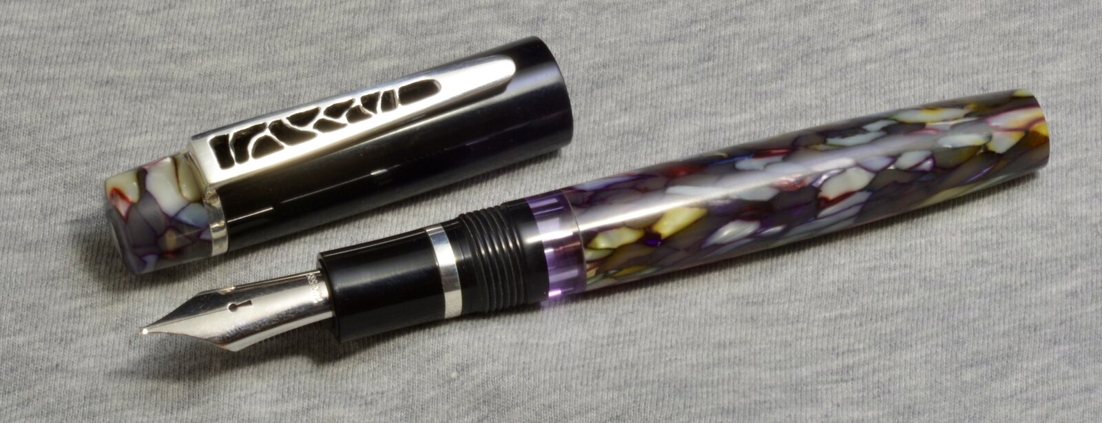

I received some "Tiffany" casein from turners workshop recently, and decided that I needed to try it out sooner than later. I'd always been curious about the material, but never had a chance to use it. I wasn't sure what to expect after hearing a decent amount of negative feedback, but I found it quite nice to work with. I didn't find any issue with water solubility, which is one of the main complaints I have heard (this was wet sanded with no warping or dissolving). I based this pen around an acrylic skeleton made from transparent purple acrylic keeping the entire ink chamber enclosed to eliminate risk of ink seeping into the casein. I made a sleeve from the casein, which was threaded on and epoxied over the acrylic body. The section and cap threads are black acrylic. Since the casein was not large enough in diameter for the cap, I used black acrylic for the cap, and make the finial from casein to be able to tie the cap to the body and make them look like they matched. I made the clip and section band from argentium, and pierced the clip to try and mirror the random stained glass pattern of the casein. This is a somewhat oversize pen, with a barrel diameter of 14mm at the cap threads, and about 5 3/8" long when capped. It uses a Bock #8 nib, and can be filled via converter or ink placed directly in the barrel, as the casein is insulated from contact with the ink.

John, that is an outstanding piece - thanks for sharing. Question: if my screen is displaying the images properly, it appears to be a satin finish rather than a gloss. If that is correct, how did you achieve it?

Superbly OUTSTANDING, John !!!
Thanks for showing !!!
Love the clip design ... pattern matching the casein patterning !!!

This is a beautiful pen. I'm also interested in your clip and band work. Is the clip made out of argentium made from sheet or strip? I assume the bands are made from strip. If yes, what size strip are you using?
Sent from my iPhone using Penturners.org mobile ap
Clip is cast from a wax model and refined with a jewelers saw. Band started out as 14g square wire, but I rolled it out so it became thinner and wider

I have a casein stash, in fact I just got more, and have that color. The subject of instability comes up a lot. I have had two crack all over the place several weeks after I made them. It's heartbreaking knowing the rarity and difficulty obtaining.
