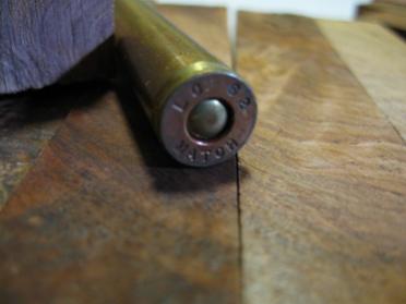

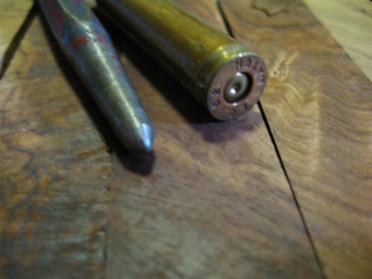

Hi Guys & Gals
I fancied doing a couple of pens from rifle cartridges but we don't have the same gun laws here in Europe as exist in the US, so ammunition isn't easy to come by…
Imagine my happiness at finding what looked like a couple of suitable 'complete' casings with leads at a flea market. I was assured these were 're-made as replicas from correct parts'. When I eased the lead tip out of the first one I realised that these were actually 'live rounds'…
I've taken the main charges out and flashed them off in the garden but I obviously have live primer caps still in the shell casing. Not knowing anything about primer caps, can these be drilled safely from the inside (to preserve the 'look' of the casing) if I use plenty of lubricant to keep the drill cool?
I realise that hitting the primer cap with a blunt centre-punch is a more fun method of disabling them but, after 40 years of woodworking, I still have all my fingers and I'd like to keep things that way…
The cartridges are both marked as "7.62" (0.3 inch?) but I can get slimline tubes inside so it should be 'do-able' I guess. I have no idea if the heads are tracer type or not but maybe somebody can tell from the photos…
Any advice on this problem (or making cartridge pens in general) would be very welcome.

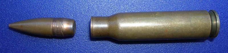

3rd picture gets me confused. Looks like there is a solid material...almost like lead still and seems like the powder may still be further inside.
Not knowledgeable with these much but I did play around with some live cartridge when I was young and this doesn't look right.
Can anyone look/check this more?

I think that third picture is of the base of the bullet, not the mouth of the casing. In most military type rounds even though the copper jacket is solid at the tip, (hence full metal jacket) is is usually open at the base, showing the lead.
But, of course I could be wrong. :)

Looks like you are right and I hope you are.
I just thought that he took the picture of the casing from both sides of the vise and it really looked wrong.

Dario, I believe that it the back of the bullet, and not looking down the shell case.

The third photo is the projectile, it is inert. Safe with the exception of being 'LEAD'.

You state ... "I was assured these were 're-made as replicas from correct parts'. When I eased the lead tip out of the first one I realised that these were actually 'live rounds'…
The first clue to me that this information is completely wrong is from your middle photograph. The small dimpled punch mark next to the primer pocket is an indication that the rounds are military in nature. Any private individual reloading bullets does not have a safe and adequate method of seating primers in this way. This is a very complicated procedure to safely perform.
The 7.62 is a NATO round. Looking at the primer this particular round has the primer seated with a secondary 'crimp' thus identifying it as a military round. This crimp is to ensure the primer is not lost during combat/training/rough handling etc.
This is evident in the middle photograph as there is a small circular punch spot at the very edge of the primer itself. This wedges the edge of the primer hole and ensures the primer is solidly held in place. Primers that have this treatment are often harder to remove from the casing than normal during any attempts at reloading the cartridge. Some primers were crimped around the entire edge of the primer pocket and these are quite often very hard to properly remove.

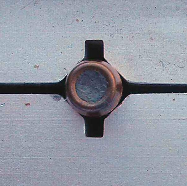

Do not put anything into the casing! Simply mount the casing firmly in a vise, held between pieces of soft wood to prevent damage to case, and firmly tap the primer center from the outside with center punch. Don't try to drive hard like a nail, just simply tap firmly and you will hear the primer fire (unless you are deaf, and if you are, do it in the dark and watch for the flash). Unless you hear or see, do not assume it has fired. You will know when it does. Wear safety glasses to protect any potential discharged matter from your eyes, and keep anyone else away when you do this to prevent any eye injuries. Make sure the bullet has been removed and the powder has been removed, or you will have an unpleasant experience. With a small flashlight, the primer can be seen from the open end. If you cannot see the primer from the open end, do not discharge the primer. Do at your own risk. Have to say that to hopefully protect me. I just fired the primed case shown and it worked fine. Only I did not use wood....did not care if case was damaged.
I do want to caution you to be very careful with live rounds. If you punch the primer in a live round by mistake, the case will probably ruture and folks could be seriously injured.
