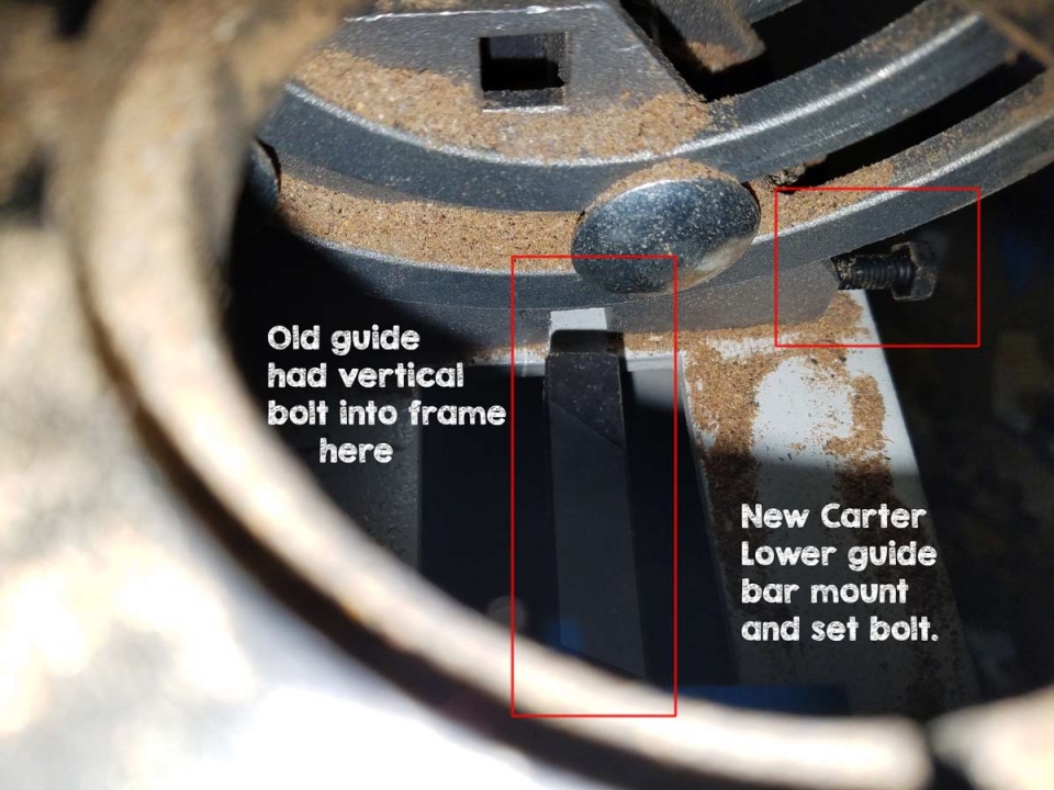

With some recent birthday money burning a hole in my pocket, I got in the mood to treat my bandsaw to a new blade and some new guides from Carter Products. I thought I'd share my experience with the upgrade. In short, I'm happy with the upgrade, but maybe not quite as happy as I thought I'd be. Time will tell, but since they're easier to adjust, I think I'm more than likely to keep the guides tuned up, whereas I didn't like futzing with the Rikon guides and consequently was not good about keeping them set up correctly.
I ordered the $209 "RIK14DMA- Rikon 14" Deluxe with Micro-Adjustable Guides" upgrade kit off of Carter's website and shipping was incredibly fast – I think I got them in two days. There was no instructions included, just a few plastic bags of parts in a box. There was definitely some head scratching as I compared the various bits that I received to the Rikon bits they were replacing.
If you notice, Carter sells two versions for the 14" Rikon upgrade kits - a "Standard Rikon" and a "Deluxe Rikon". The difference looks to be primarily in the lower guide, where the "standard" expects to be bolted to the frame, and the "deluxe" expects to have a square hole receiver/set screw arrangement. Even though my original lower guide was bolted to the frame (so appears to be a better match to the Carter "standard Rikon 14" guide), it does have a square hole in the right place to accept the "deluxe Rikon 14" Carter guide (and I scrounged my own M6x40 set bolt for it).
So... even though I clearly have a saw labeled "Rikon 14" Deluxe", the Carter upgrade kit marked "standard" looks to be more of an exact match for my old Rikon guide. However, I actually like the way the "Deluxe" Carter attaches better. I don't think it matters, but there's no provision on the Carter guides for the plastic blade guard that attaches to the lower Rikon guide.

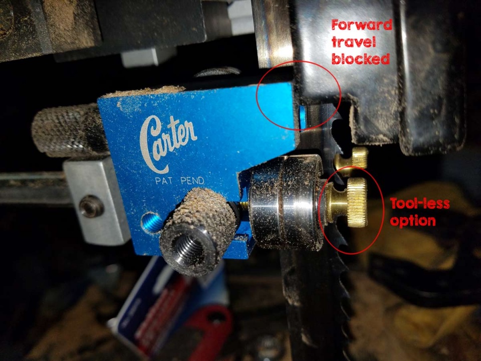

The upper Carter guide is where I ran into a little issue. I was only able to get the edge of the guide to within 1/8" of the back of the blade gullet, rather than the suggested 1/16". The forward travel needed is blocked by the Rikon blade shroud. I'm willing to live with it, but have contacted Carter to see if I'm missing something about the way I installed it and will update this post if I hear back from them.

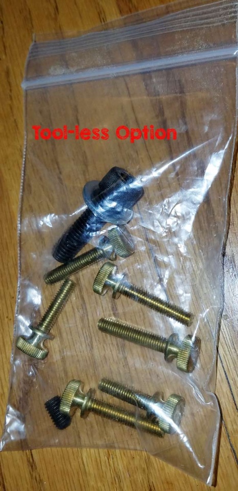

Each of the Rikon options from Carter (standard Rikon 14 and deluxe Rikon 14) also has separate version that is tool-less for an additional $30. I got this tool-less version. It looks like all this amounts to is an extra bag of thumb screws in your kit so you can remove the guide wheel's Allen screws from the non-tool-less version and replace them with the thumbscrews.

Thanks for this thread. The unsealed lower guides on my 10-325 have failed & I plan to order some Carter guides. I've been trying to decide which ones - after reading this, I think I will go with the same ones that you ordered.
First off, Kudos to Carter for emailing me and calling me back.

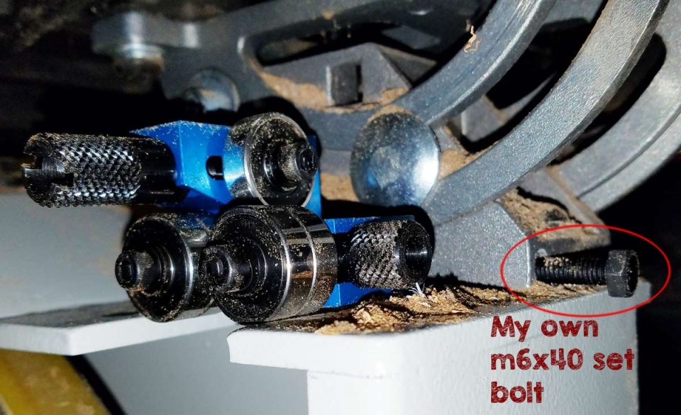

Regarding the lower mount attachment... from my conversation I gathered that Rikon used to only attach their lower guide via the post/set screw method, and, in fact, their saws are still manufactured to accept that for now. However at some recent time, they started tapping the frame and mounting their guides with a horizontal bolt. So the Carter guide attaches the way the Rikon used to. I actually prefer the feel of this "old way" to the new way my Rikon guides were attached, so all's well that end's well.
Regarding the upper mount and the 1/8" or so of adjustment it seemed to be lacking because of the collision with the blade shroud... that's just the way it is - it's not a perfect fit. The shroud is already notched, just not quite enough to suit the Carter guide, and there's nothing structural that would prevent me from taking my Dremel and notching it another 1/8", which is what I think I'll do.
In summary and in hind site, I'd order exactly the same thing again. The two pieces of advice I'd have are...
1) make sure your Rikon has that lower post hole to receive the Carter guide, especially if it's a newer saw (mine's a year old). If your existing Rikon guide doesn't use that post hole, figure on a trip to Menards to grab an M6x40 to use as a set screw for it.
2) understand your upper guide side wheels may not quite sit as close to the gullet as you'd like unless you do a little work with your Dremel. The thrust bearing has adjustment forward/backward, so no issue there, and that's more critical anyway.
