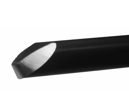

In case anyone wants a Thompson bowl gouge with a parabolic flute see here:
Also available with a Thompson handle or wood handle.
Not selling; don't own one; just learned about them talking to Lyle at the AAW symposium last summer.
I DO own a few of the Thompson handles and like them a lot.
