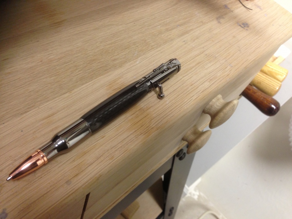

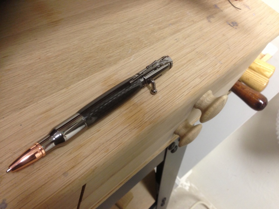

Don't over turn..(cut below the clear acrylic). Use sharp tools. Take your time...these look great when finished. Please excuse the photo.
