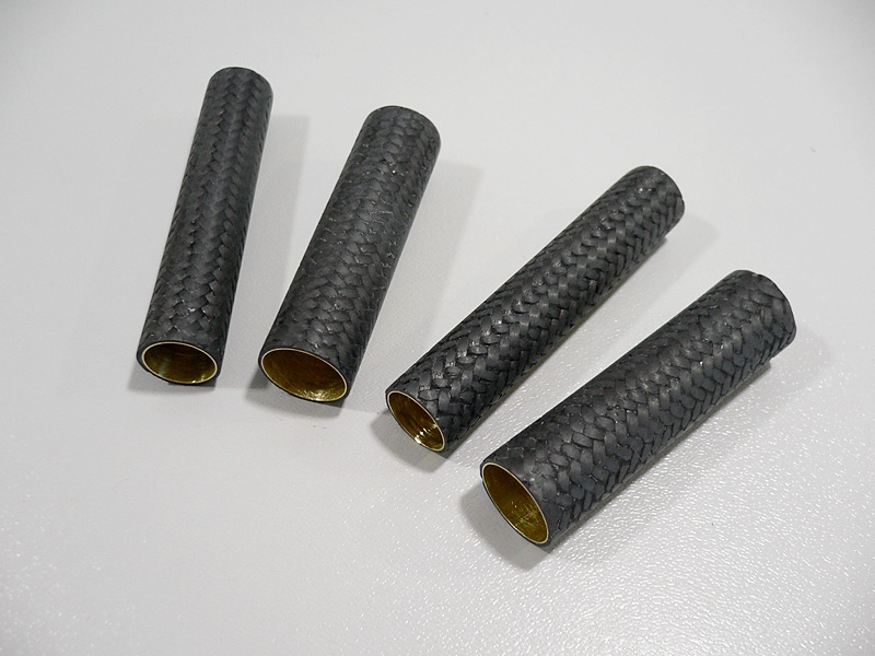

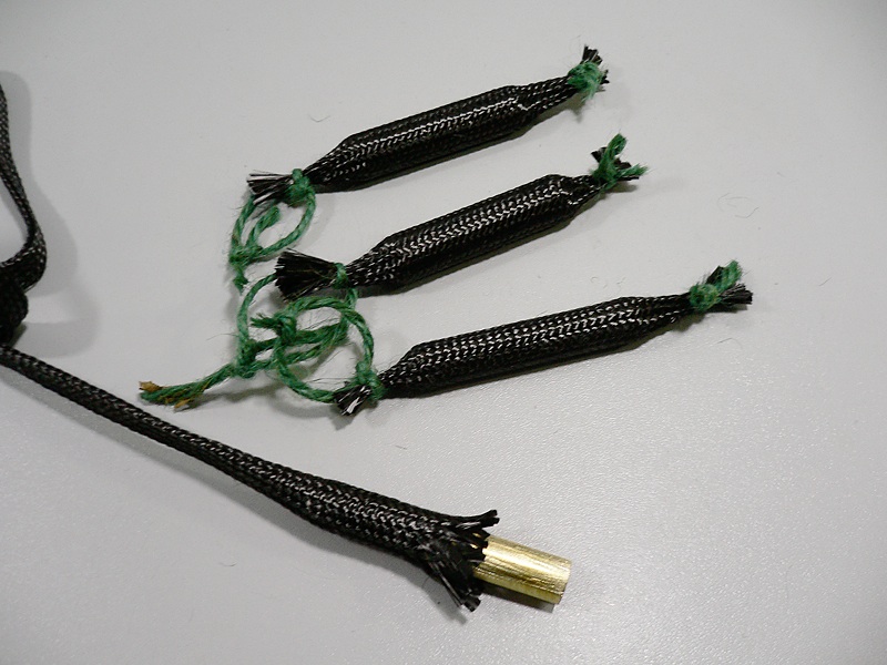

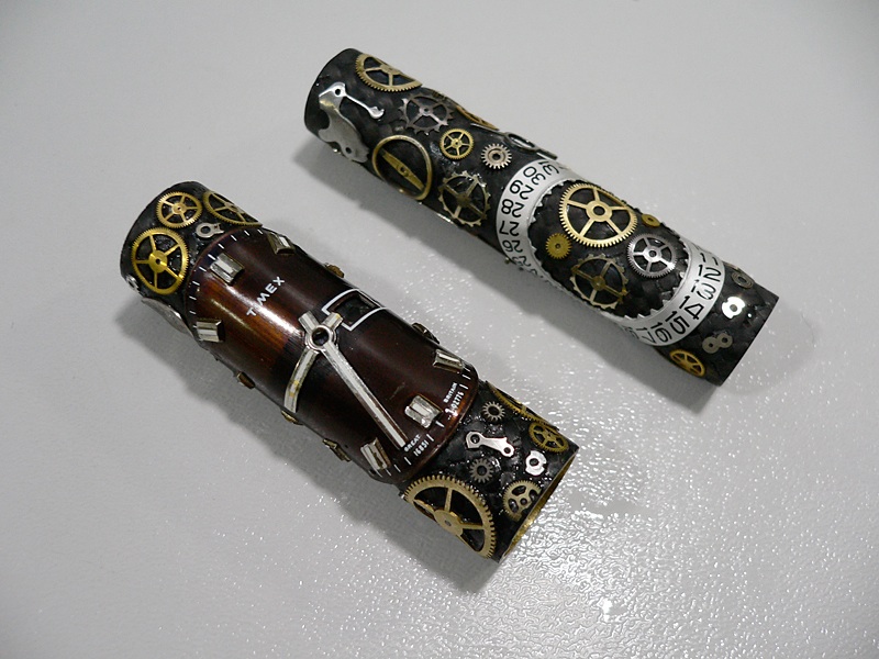

My procedure is as follows. Slide the sleeve on the pen and tie up the ends. Flood and I mean flood the CF with super thin CA in an effort to replace all the air caught in the fibres with CA. Allow minimum of 24 hours to cure. I then trim them, square up the ends and wet sand them until almost smooth to remove stray fibres and the excess CA. Allow 24 hours to dry and then cast in PR.

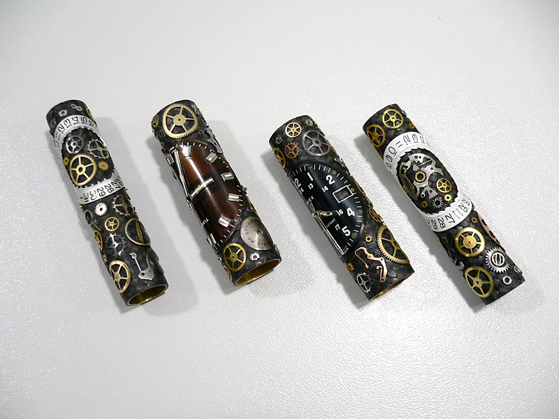

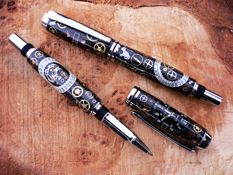

Couple of progress shots of a couple of watch parts pens below if that helps. First one shows the results when sanded.
