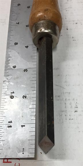

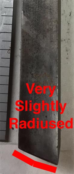

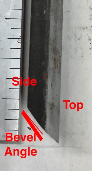

Below are some picts of the end of a HSS chisel that was the upper end of HFs when they had 3 levels of turning chisels years ago.
• The first picture is the bottom and you can visually determine the bevel and angle.
• Picture 2 shows the miter angle that I chose by the most comfortable presentation angle to the blank for me. I am right handed. But I am considering a left hand one for getting into corners from the left side.
ALSO note that I put a very slight radius on the scraper. This is because when I had it straight, if my hand movement was off even a miniscule amount it would render a straight cut with a gouge. That very slight radius, guessing 12 in radius or more, helped considerably.
• Picture 3 shows the bevel angle.
• 4th picture shows the scraper from the edge so that the face is fully visible. And in this picture it is barely visible but the end used to be mirrow shined, and you can see a reflection of some writing on the box it was setting on. In the original picture when blown up, the writing was visible and readable. (And it has been 4 years since last used.)
I haven't used this chisel in 4 years as It has been lost until last week. I had tools in Japan and tools here in the USA. When I brought all of my tools home from Japan, my shop has been basically a storage shed for tools. I gave a dual bevel miter saw, a TS, DP and a few other tools to a son in law this summer, and found some of my tools from Japan.
I have been using carbide tools for some basic turning a few times in the past 4 years. They just were not as sharp as the HF chisel that I made into a scraper. Yes, I do sharpen it several times during a segmented turn, but I can tell the difference in feel between a very sharp HSS and a new carbide. The HSS beats the carbide for me, but I do loose time which is not a problem for me. For me, it is not about how fast I get something done, but how great I can make it. If I were to try making a living and needed production, I would most definitely switch to carbide full time. I was hoping that I would find carbide has become as sharp as HSS today.
