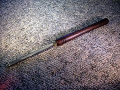

I'm now a fan of the Woodchuck Pro. Just got it a little over a week ago but I know it and me are going to get along just fine.
