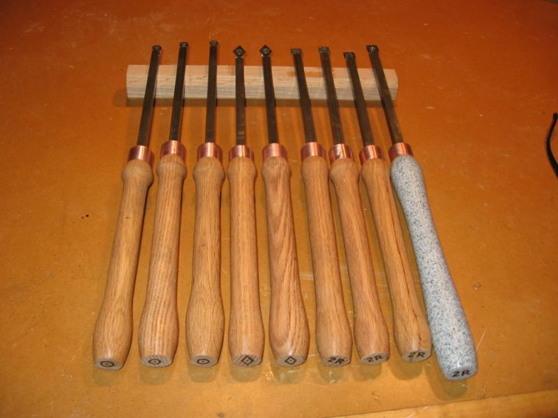

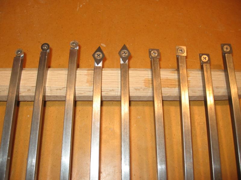

Make your own. Capt. Eddie explains it all and sells the carbide with the screw to attach it. I spend $.85 for the 3/8" steel rod, $6 for the carbide (average), $1 for a copper pipe fitting and a scrap of wood. That's $35 give or take for a set of four.
