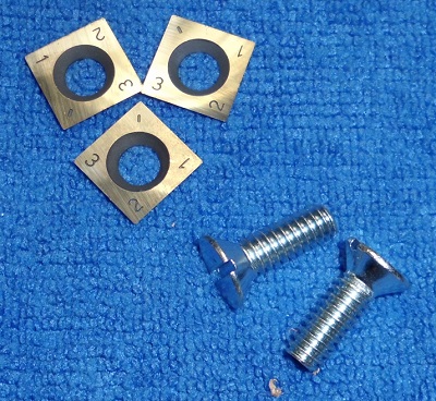

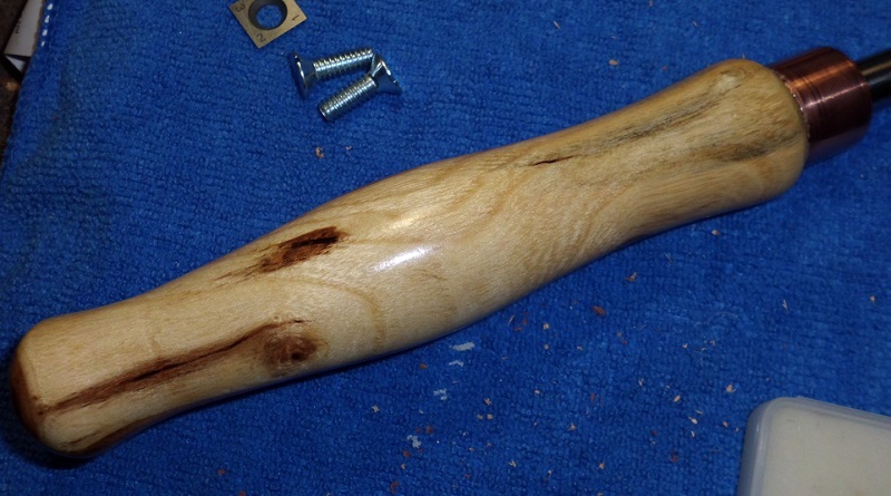

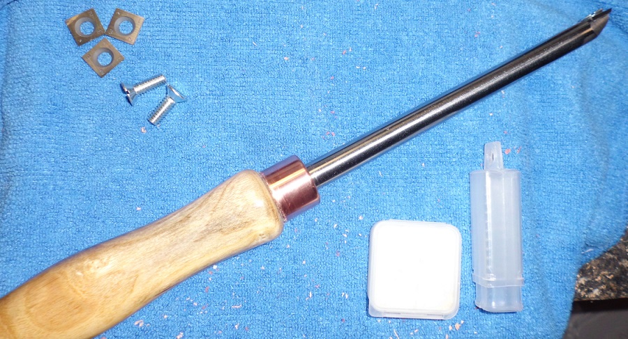

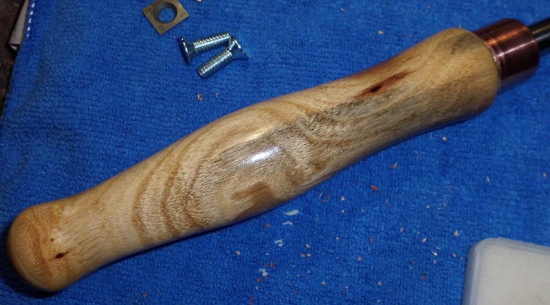

So ... a bit about this tool. Handle is solid Mesquite. It's from a branch, and has a good deal of sapwood all around it, but the core is good hard heartwood. It's solid, unlike much of the wormy mesquite I managed to get off the property. The ferrule is a 3/4" copper straight fitting, split in half. The shaft is 12 inches of 1/2" round cold rolled steel... 4 inches of it is buried in the handle. Weight is a good deal forward, where it will be supported by the toolrest.
The screws are a tad bit oversized, in my opinion, but I can't seem to find smaller screws in this area of the size I need for these bits (center hole is 1/4" diameter). The bits were bought in quantity of 10, paid approx $2.70 per bit through Global Tools. 14mm square, .5mm radius corners (these are NOT the radius bits you are used to, they have SHARP square corners). As you can see from the pictures, everything on the blue towel is going to Eric. (minus the sawdust, lol ...)
1 tool handle, with carbide bit and screw (there's a tiny chip on the corner of this bit, it'll wear away with sharpening eventually)
3 spare carbide bits
2 spare screws (left long)
1 holder for carbide bits
1 holder for screws
