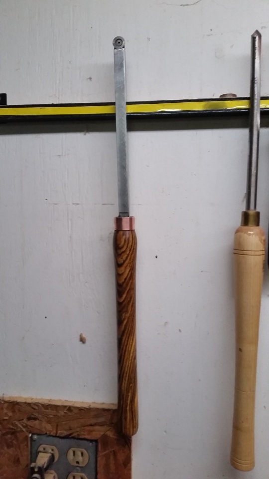

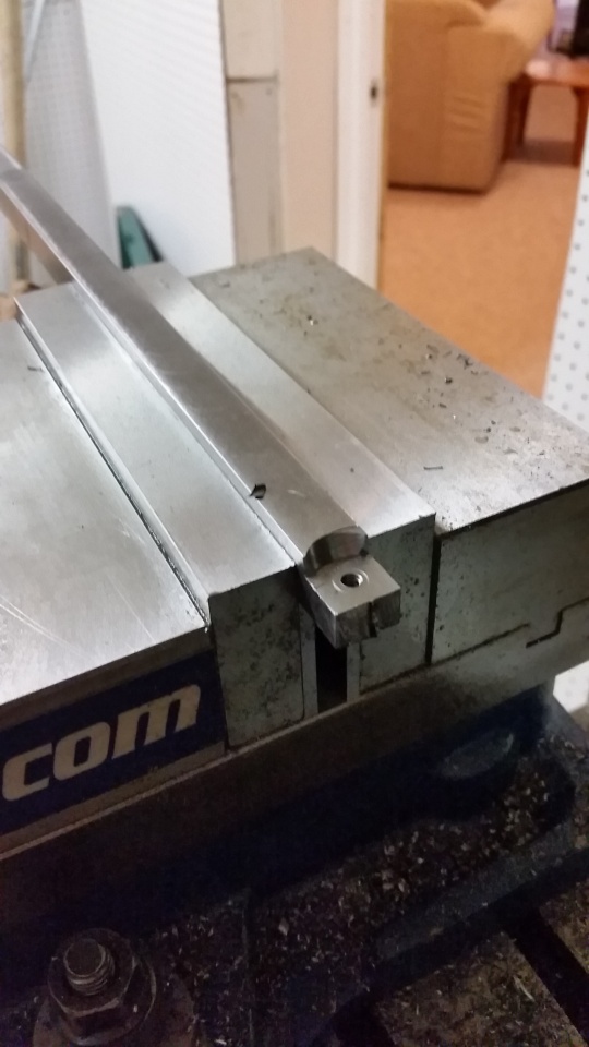

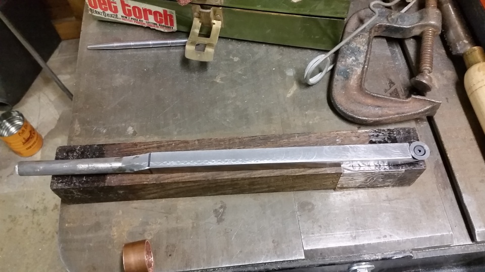

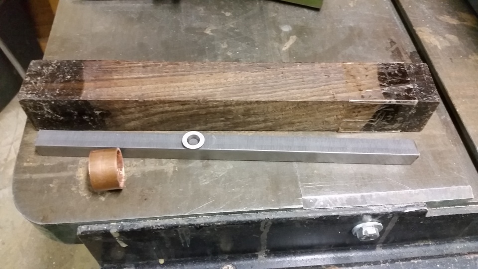

A friend of mine has a milling machine, so I called in a favor to see of he could help me make a carbide tip tool. We made it out of 1/2"x1/2"x12" S7 tool steel and the handle is made out of Bocote. I wanted a long carbide hollower to make it easier to hollow out travel mugs.

I've been wanting to use it, but the shop has been way to cold in the shop since we made it. hopefully with the weather warming up, I will be able to try it out.

Nice looking tool, but I sure don't like using cutters that large. They can get grabby. Maybe as a finishing tool, but not one to rough off a lot of stock. Yup, let us know how you like it.

You can get curved tool rests that reach inside the bowls, or curved around the outside. I use them, plus I use a longer straight rest and send it inside the bowl as well. Remember in using a scraper or carbide tipped scraper, the end of the handle must be higher than the tip of the cutter. Get the handle too low, it gets grabby.
