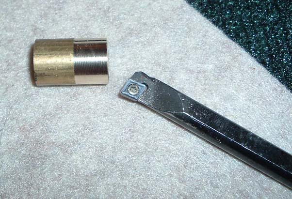

John, I recently did some trials on various metals with my newly made carbide insert tools. The tool I used has a woodworking type 11.7 mm radius blade. It is the kind that are flat on the top edge and tapered on the sides.
This was done on an HF woodworking lathe.
I wanted to see if I could turn copper, brass and aluminum any better, mainly because I cannot turn copper very well at all.
All 3 turned much harder and left a nasty finish. I tried lube, different speeds and even turned the blade upside down. All to no avail.
My conclusion is that those metals turn better with the carbide blades made for metal lathes. I use such a blade in a tool-holder and homemade handle. as pictured below. This is used on the woodworking lathe but because of the type of blade, it does a decent job on aluminum and brass. It does better on copper but not well. Copper just gets gummy and chatters.
So, maybe that info will be of help.
