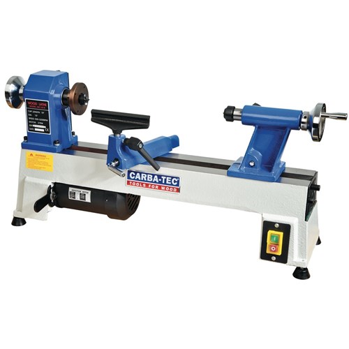

When I first decided to start wood turning in general again and pens in particular I was lucky enough to buy a new old stock Carbatec mini lathe which is complete with every thing except a motor. To identify which model it is, it has a 5-step pulley and an on-off toggle switch on the front. There is a mains lead but it has two flat pins on the end, not a UK one with three rectangular pins. It looks very similar to one of the lathes used in the Bonnie Klein book, but it looks as if the motor should be slung below the mounting board, in the same way the old Myford ML8 were, rather than at the back of the board as her's is. There is only a spring loaded hatch at the back of the headstock, which looks to just be for the manual speed changing. Lastly, it is all black!
I am looking for a manual for it, along with advice on motor mounting pleas. I've tried lathes.co.uk, but they have nothing to help me.

This lathe?
https://www.carbatec.com.au/woodtur...athes/mini-lathe-economy-1-c-35kg-84-43-30-cm
