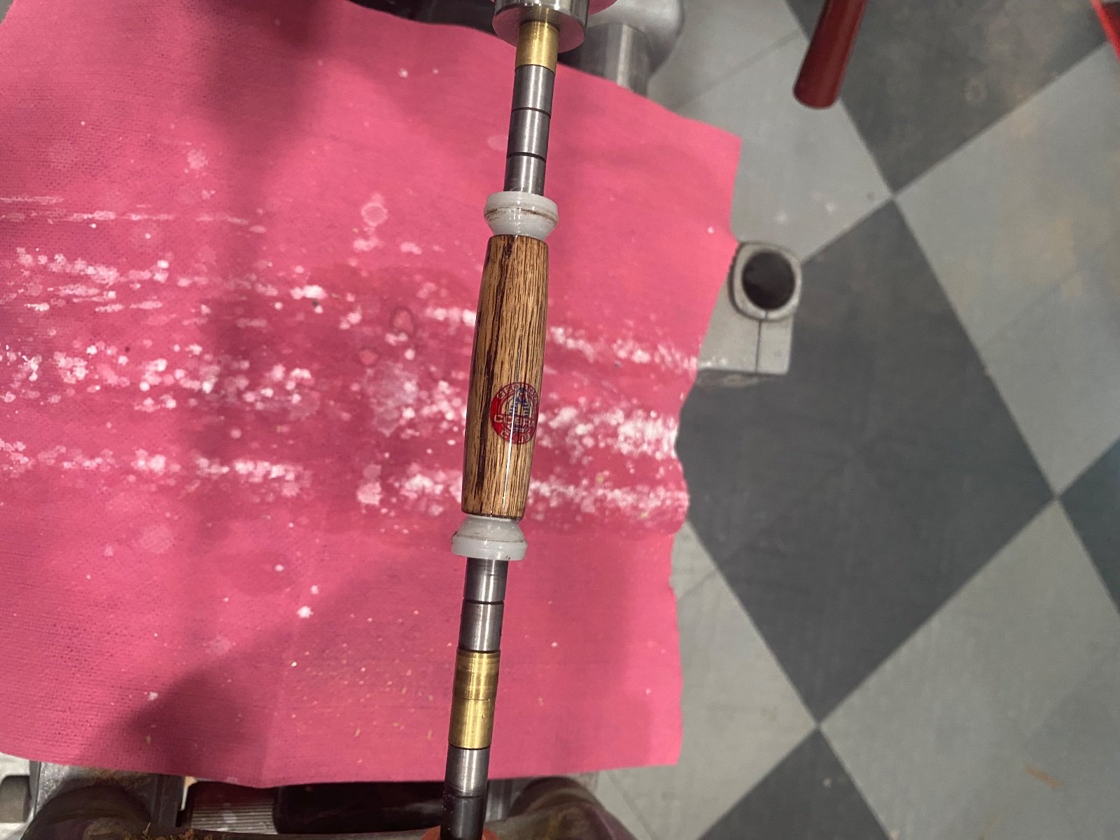

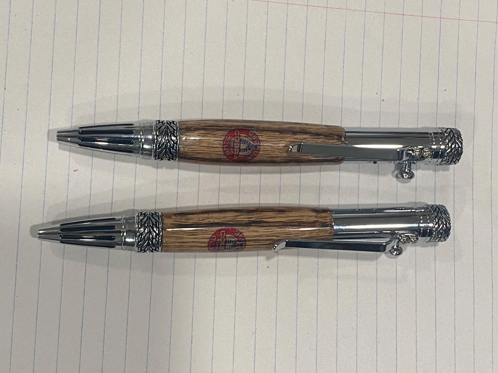

Turned these for some buddies in our car club. 5 speed "Shifter" and tire accents. Added the club logo with a water slide decal and then 6 coats of CA

May i ask how you did the water slide decal? Is it printed on a regular printer? If so what do you use for the medium to print on?
Prinited on an inkjet. I got the paper at Wal Mart. I let them dry overnight, then misted them with gloss clear spray paint to lock in the color. The 2 coats of CA on the pen blank, apply the decal, then more coats of CA after the decal was dry.
