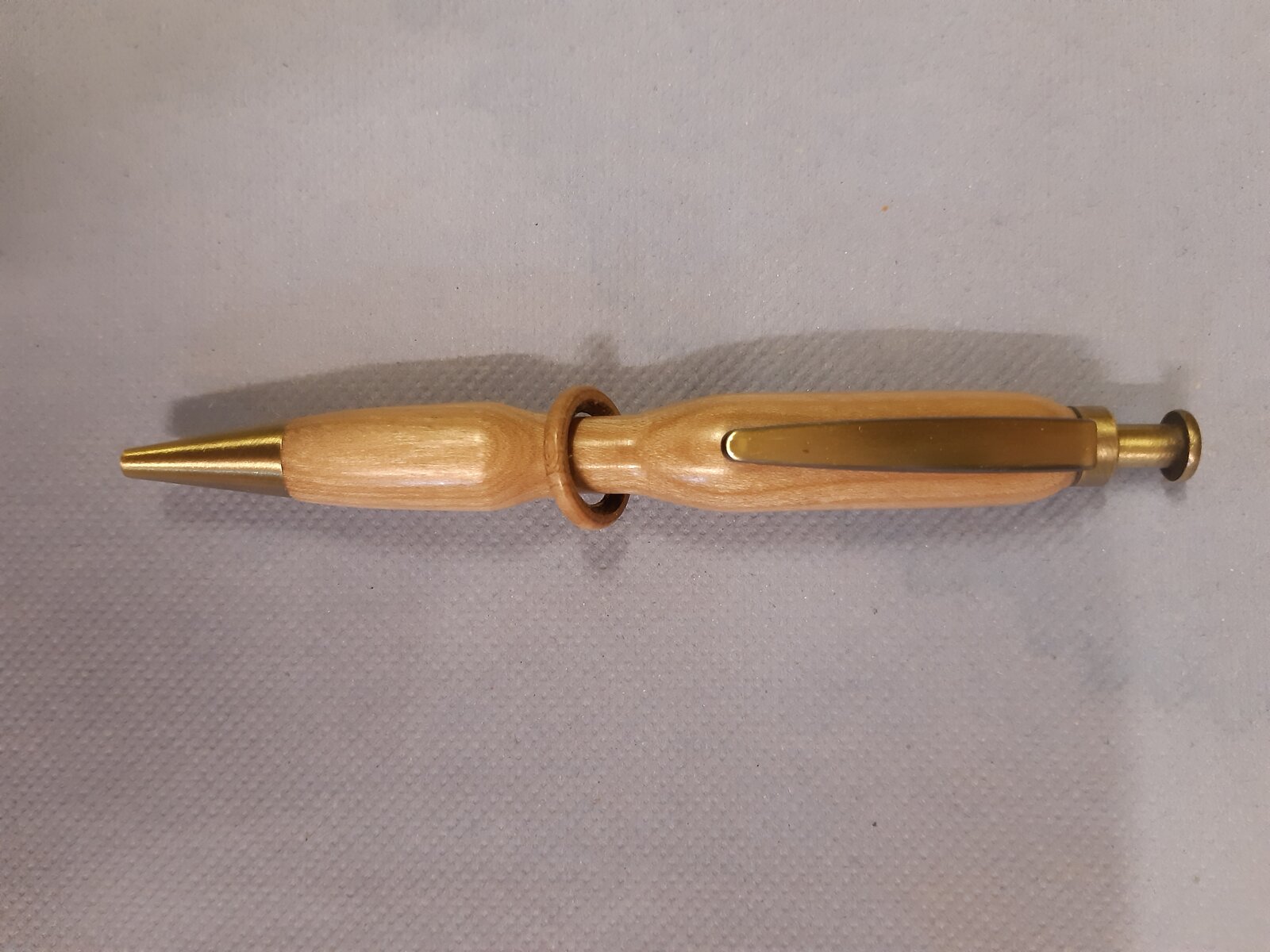

Not the most attractive Pen but a challenge in turning. For me anyway. Don't think it win any design awards and not a very practical Pen,

I think it is GREAT !!!! . Well done !!!
But how do you change the refill ?????
Kcimdrib
Nov 1, 2020
1,378
UK
The nib screws off no problem. I made my own ring turning tools from Masonry Nails.
When you turn the ring not alot of wood between the tube possibly about 1.5 mm
May make another and try to put a bit more style in it.
Thank you for your comments.

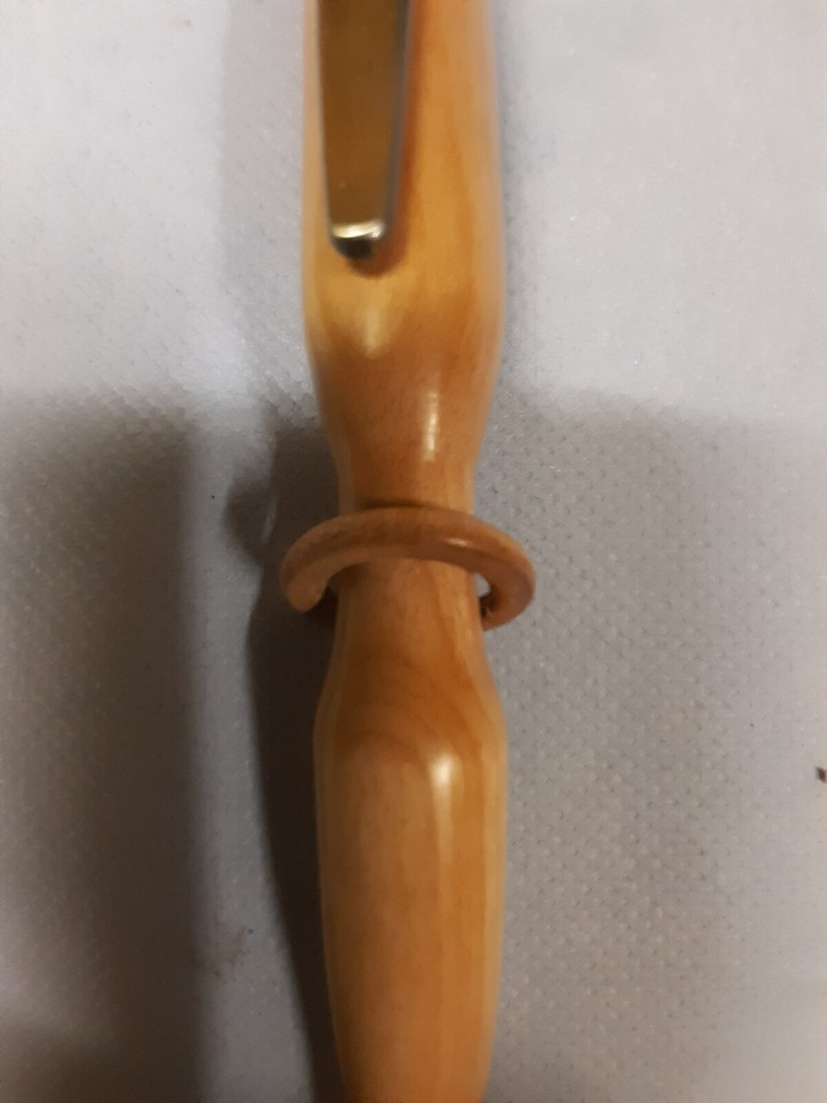

Not a pen but Captive Rings.

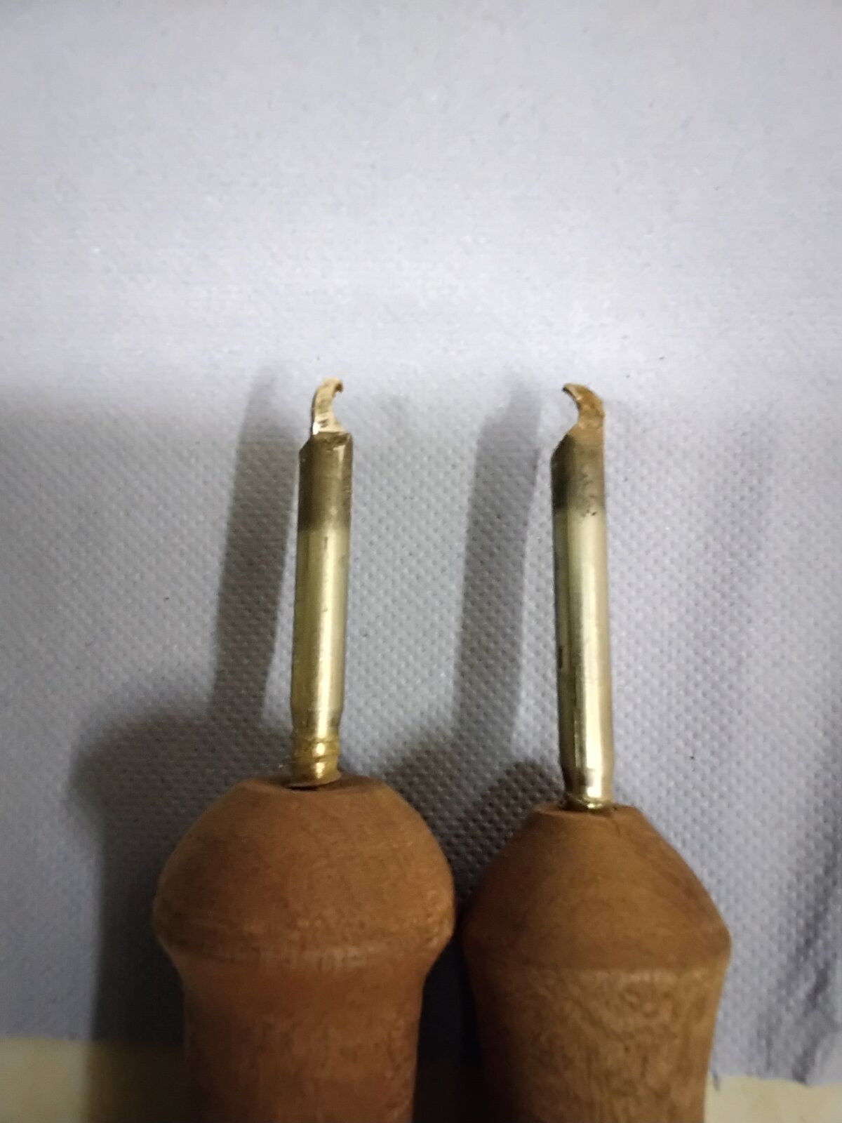

Would you mind showing a photo of your custom tools? I'm intrigued. The ring is very nicely done.

They are quite small and think I used a Masonry Screw but you could form them with any hard material then grind them. I made these years ago hope this helps.
You do need to form a right hand and left hand.
Hope the photo helps.

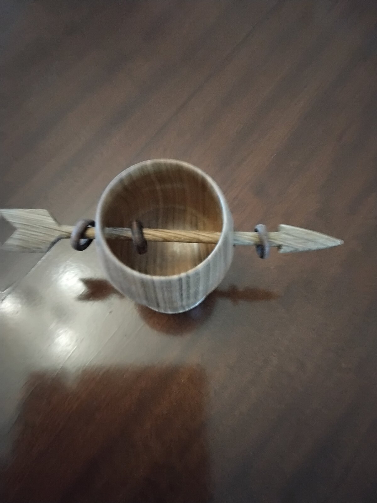

penicillin
Feb 27, 2019
1,036

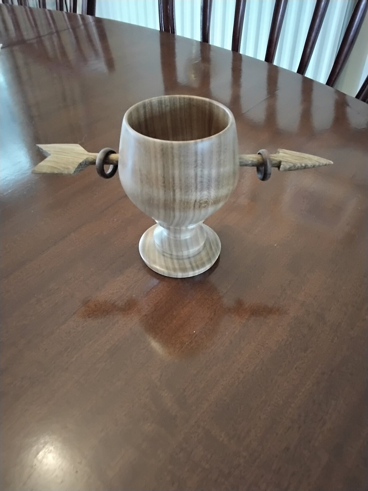

I am very impressed with the arrow / rings / cup. Steam? Glue? Something I missed?
Would you care to give me a hint (or a web link)? Thanks!
Kcimdrib
Nov 1, 2020
1,378
UK
First turn the Goblet and drill two opposing holes. Then turn the Arrow leaving the point not shaped. Place this end in boiling water for about 15 minutes take out and compress in a vice leave overnight. Take out the following day and it should pass through the holes in the Goblet. I turned the rings separately and placed these on the arrow. Now place the arrow tip back into boiling water again for 15 min.
It will then return to shape. Sand the arrow to shape.
Its much easier to do than explain.
Hope this helps and you can find videos on YouTube.
Mike

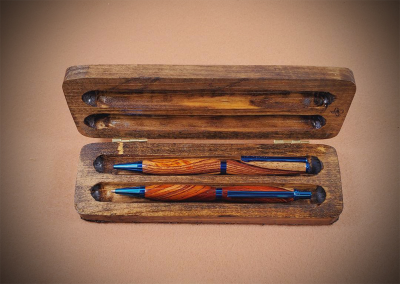

Thanks for listening Mike!. I haven't done much pen turning in a while. Here's a pen & pencil set I did in cocobolo with a pen box made of pine, I did back in Oct.
Mike
Your explanation is very clear and easily understood. Thanks for sharing!
