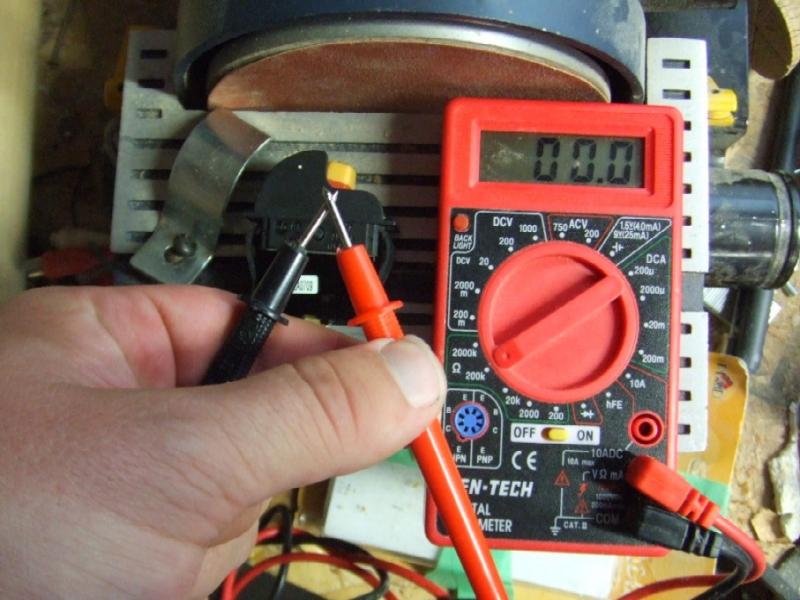

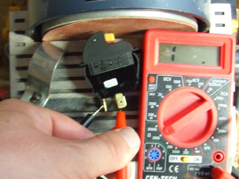

Got the camera working, sort of! Here are some pictures of the switch being tested.
Picture 1 - crossed probes to make connection
picture 2 - baseline (no connection)

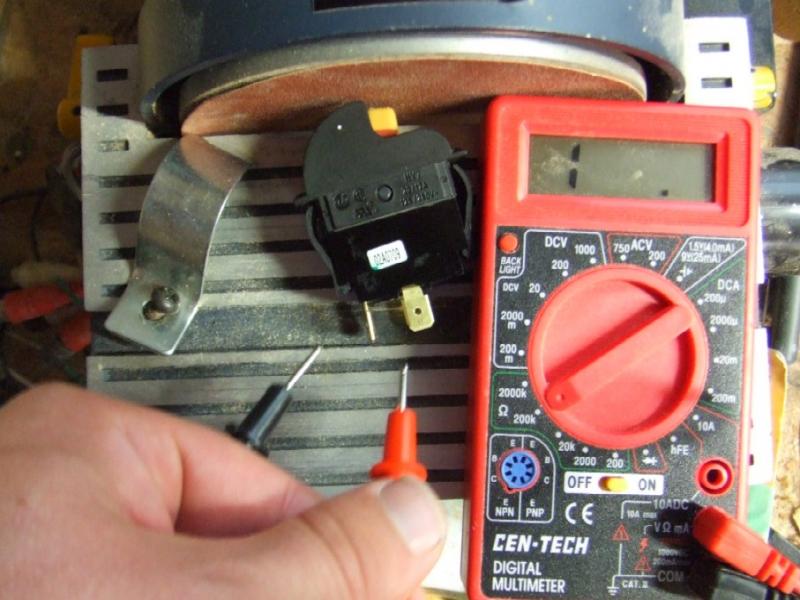

picture 3 - switch set to 'on', testing one side poles
picture 4 - switch set to 'on', testing other side poles
Different measurement for pictures 3 and four:
One side shows 0
Other side shows 1

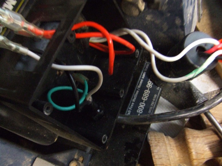

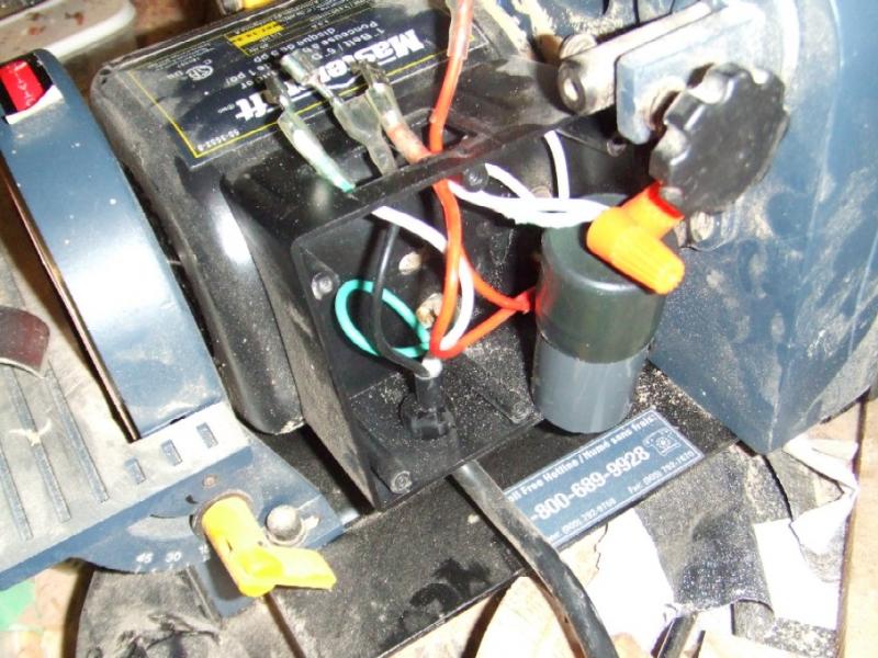

Some overall pictures of the wiring:
Model is 55-3512-8, but it's a Canadian Tire tool, so it's only sold there, and there's no schematic available anywhere, it seems...

Looks to be DPST(dual pole single throw) The white and black come from the wall cord correct? When in off position there should be nothing flowing (meter should read 1) between anything on the switch (out of circuit). When ON (closed), the white should go to to 1 red on the same side would go to 0 on the meter. The black wire will go to the other red (again meter will read 0). Across the connections (white to black & red to red poles - OUT of circuit or you'll read the motors resistance) should read 1.

One side of the switch is bad.... the side that reads 1 when the switch is on. When the switch is off both sides should read one.
That's exactly right, except while the white wire to the red on the same side changes, the black wire to the red wire on the same side never changes from 1 to 0
So the switch is kaput :smile:
Hey, these multimeters are neat!
You're thinking it from that last pic on the 1st set right? I saw that but I couldn't tell which connectors he was touching clearly enough.
Yes, that's the one - tough to take a good picture and hold the leads at the same time.
That last picture is the hot side, and it's always reading 1, so the switch is bad, I guess.

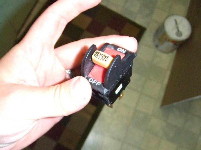

You could always take the switch apart and see why it stopped working. Might just be dirt on the contacts, or something else simple. Since you are going to throw it away anyhow, you don't have much to lose.
If you aren't sure how to put it back together after you open it up, just toss it.

Measure the size... some vary. Do you care about the removable safety "key"? If not check, local auto and boat part stores. Check then, many will have 2 ratings on them, 1 for DC and another for AC. Also, you could also use a DPDT and not use 2 of the terminals.

This is an excellent suggestion... It won't be as "dust proof" any more, but a little cleaning or adjustment it may work again.... Now that you know how to test it, you'll know if it works when your done. :wink:
