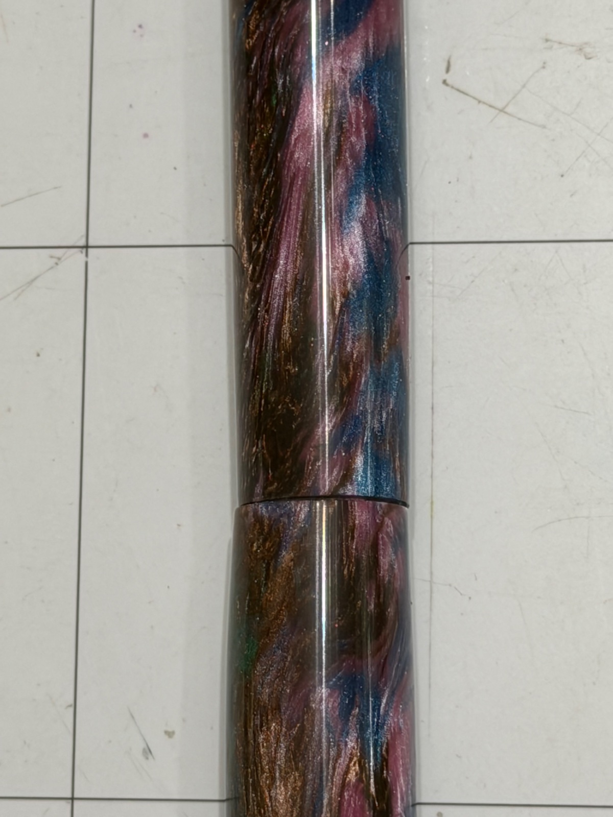

That vague title is what I have recently found in two pens. After I finish shaping the pens, the bottom rim of the cap and the top rim of the body don't match exactly. One is slightly out of round I think. This is only on pens that have the same diameter, cap isn't proud. It is so slight I can hide it with sanding to blend but it makes me crazy. The only thing that is different is I bought a bearing collet nut, the piece you screw onto the collet chuck. Any ideas. It's not every pen, but any is too many

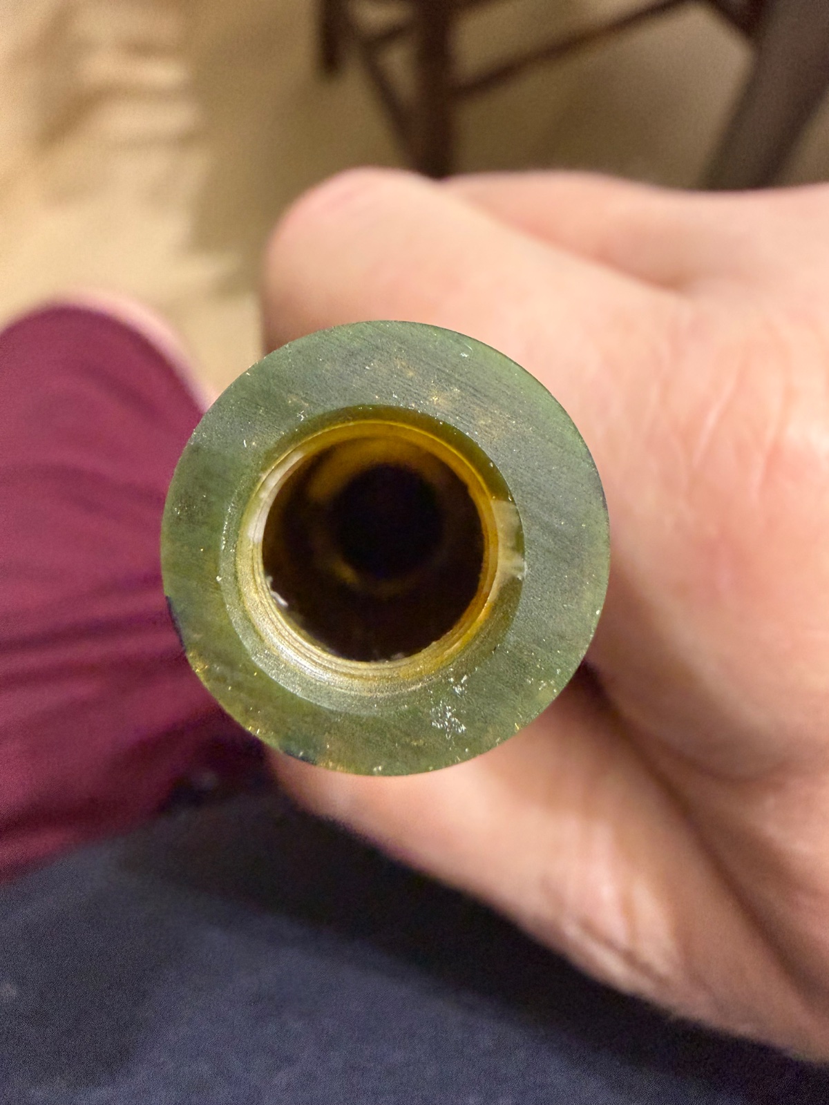

  5. If I shape the cap to be proud, I don't notice the out of roundness, very slight and if I see it on the "completed" pen, I can screw the pen together, place in collet and wer sand it down to flush to mask the out of roundness

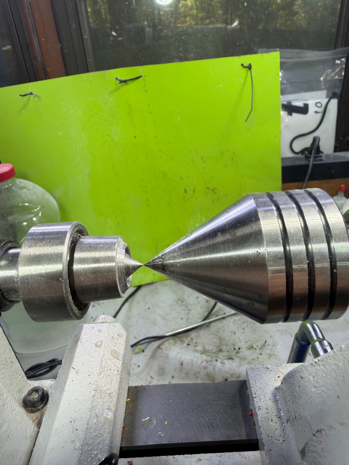

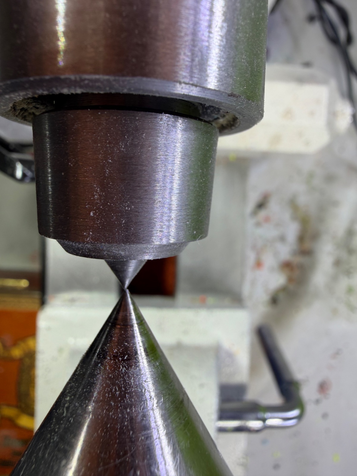

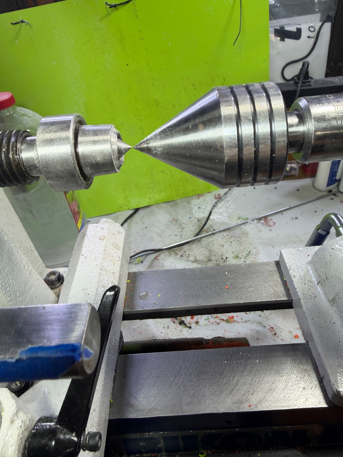

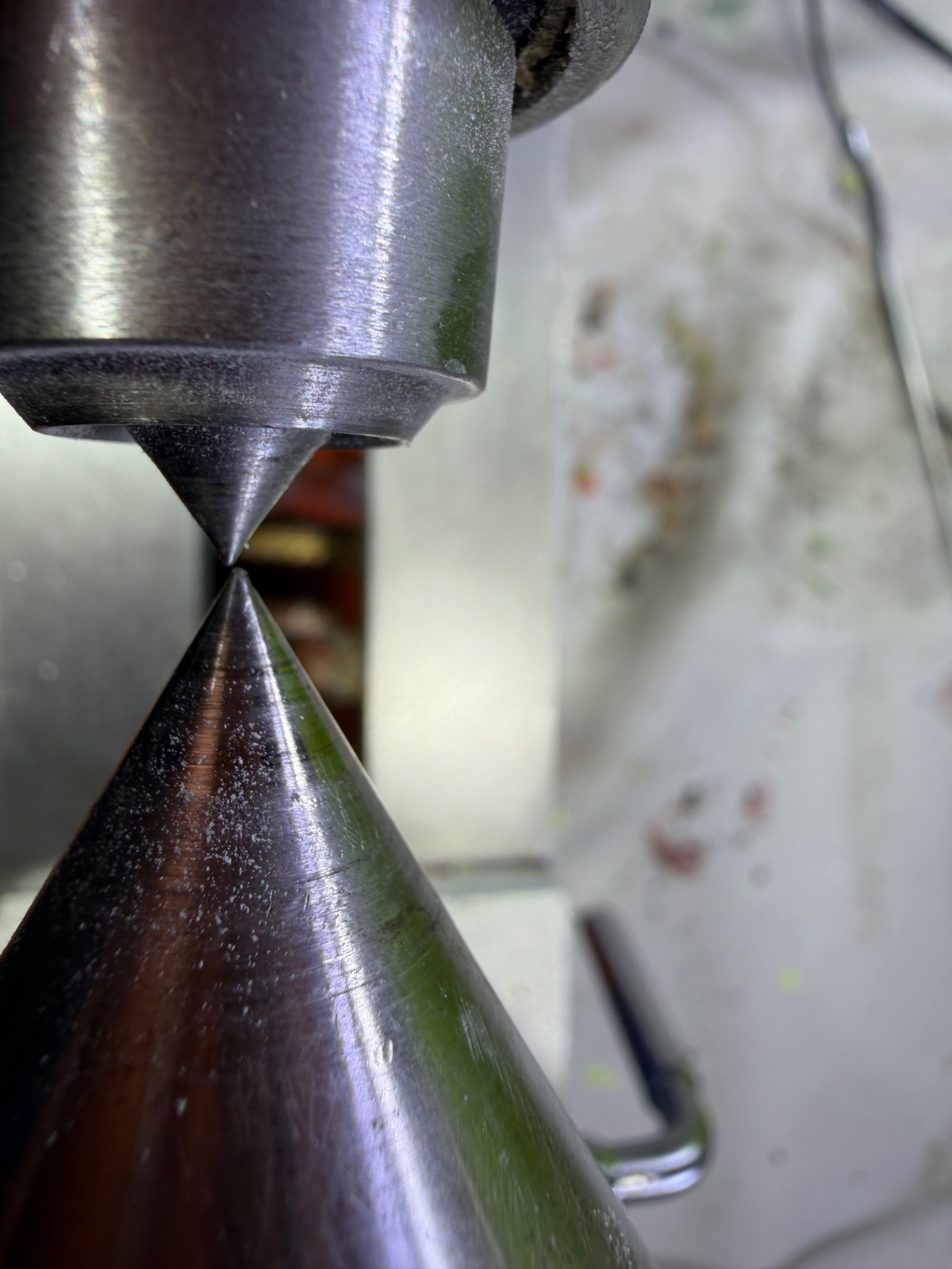

More info. First photo is end of cap for clip. It's off center. The following photos are tail stock head stock alignment.
I found out the reason, but not the cause
