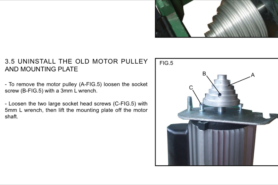

Did you pull the plate as well? See pic:

The pully is caping over the shaft so a puller has nothing to pull against
I'll try heat I guess...but I can call them tomorrow and see what they recommend about that. I hope I don't run into the same problem on the spindle pully.

sorry I did not notice the pictures. I have done things similar to that and wedged two wedges one on each side. the pulley may not budge quickly but over some time it may beak loose. good luck

Try RTFM?
- Remove spring loaded motor locking handle.
- Uninstall the belt from the lathe.
- Loosen the nylon lock nut (A-FIG.4) using a 13MM wrench then remove motor.
- To remove the motor pulley (A-FIG.5) loosen the socket screw (B-FIG.5) with a 3mm L wrench.
- Loosen the two large socket head screws (C-FIG.5) with 5mm L wrench, then lift the mounting plate off the motor shaft.
Things are 'stuck' for a reason. Once you find that reason all will become clear at that point. There is no sense in forcing things.
This is just the redneck in me popping right out. BUT figure 5 in step 3.5 of the instructions show the two screws holding the mounting plate in place ARE LOOSENED. Additionally, in the drawing, those two screws appear to line up on the edges of the pulley.
IF (BIG WORD, here) this IS in fact the case, by loosening those two screws as far as possible, SHOULD (another BIG word) allow you to lightly tap the back of the mounting bracket thus forcing those to screw heads to lift the pulley off the shaft.

The pully is off ---- I drilled a hole in the motor shaft cap on the pulley and used bearing pullers to remove it. The shaft of the moto looks a little battered and I know that I didn't do it so part of my problem was in the motor shaft itself.
