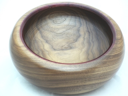

As hard as I try I can't seem to get rid of those rings! The bowl looked halfway decent until I saw the rings on the screen! Any ideas?:confused:
(The Walnut bowl is 3" x 9")

I have the SAME issue.. sigh.. the only thing that has helped me is I use carbide and one motion from the side clear down and across to the middle. Then I sand with a 2 inch sander.. from 80 grit to 320.. and then I look at it again.. and often start over at 80 and resand. I know there has to be a better way, but my thinking is that for me it is lack of skill at this point and I am hoping the more I turn the better I get. :)
I have had decent luck with a soft density disc holder mounted on a drill. The short fall is that it is hard on drills but the cheapest variable sped harbor freight drill lasts well and can be replaced fairly cheaply. I use the velcro holder and sanding discs and sand thru 800 grit.

Getting really good control of your bowl gouge and having smooth fluid motion is the best way to deal with this problem. But that doesn't happen overnight. Also make sure your tool rest is free of nicks, bumps or anything else that may inhibit a smooth motion while turning.
Until then, using a large radius shear scraper is a lot easier than tryig to sand out the ridges. Something like the sorby multi tip shear scraper with the tear drop cutter attached. That what I used to use. It's not as cheap as sandpaper, but then if you go through enough sandpaper and burn up enough drills....and then there is all the time that sanding takes....and the dust....and the probability that sanding won't get rid of the ridges anyway.

G'day mate,
Ed McDonnell, has gave you a excellent tool suggestion. The other toll that will improve that sort of work is the 18mm round carbide tip, that you can make the shaft and handle for or buy the tool already made, there is someone on IAP that makes them...!
Those ridges are created by a tool that is too pointed, not exactly ending in a point but with a very small tip radius. If you use a bowl gouge, sharpen it right and then try to use the tool on its bevel and backwards, in a scraping action, very gentle touch and interrupted if possible, start at the middle/centre and come back towards the piece edge, slow but not too slow as you are taken thin passes, only...!
Sure, I would also suggest the flap disc or the 2" sanding pads either on the grinder or on a dr
If you ever consider to buy a proper flap disc sander that will me sanding the inside of the bowls, a breeze, buy one of these, Proxxon LHW Long Neck Angle Grinder - Modelling Tools - Modelling - Woodturning & Crafts | Axminster Tools & Machinery they are the "business"...!:biggrin:

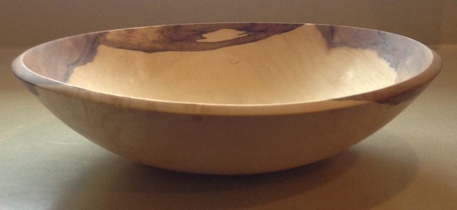

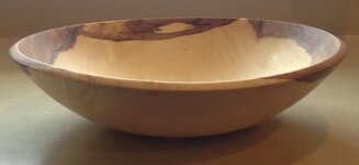

Pretty sure you can't get a bowl gouge into that tight radius anyway. A scraper or power sanding is the way to go. Consider a bowl shape that has a smoother curve up to the rim like this 14" soft maple bowl. Lots easier and more artistic in my opinion.

Different approach on a maple bowl
There was a lot of information & suggestions that I tried to incorporate on a maple bowl that I will try to post in the morning. 1) I spent more time sharpening my bowl gouge, 2) I also sharpened the large scraper, 3) I would have liked to change the shape of the bowl as suggested but it was already hollowed out ( the sharp interior radius does make it difficult to get the gouge to cut) so on future bowls I am going to make them with a "softer" radius, 4) I did start using a round carbide to make the last finishing cut and then, 5) I found my small 2" madrel & sanded from 80 grit to 320...starting @ 80 grit made a huge difference...Thanks for all of the help...I really didn't realize that many do a lot of sanding.....(passive didn't work):biggrin:
