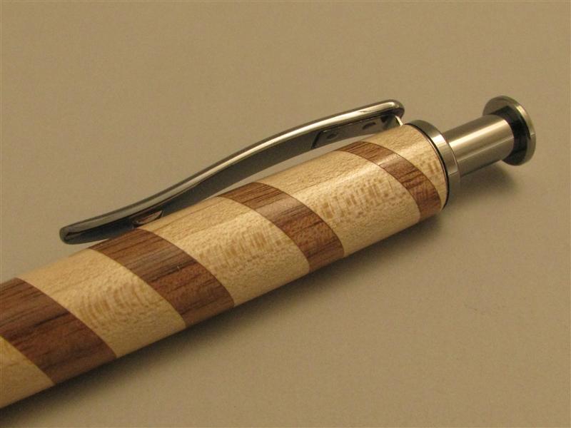

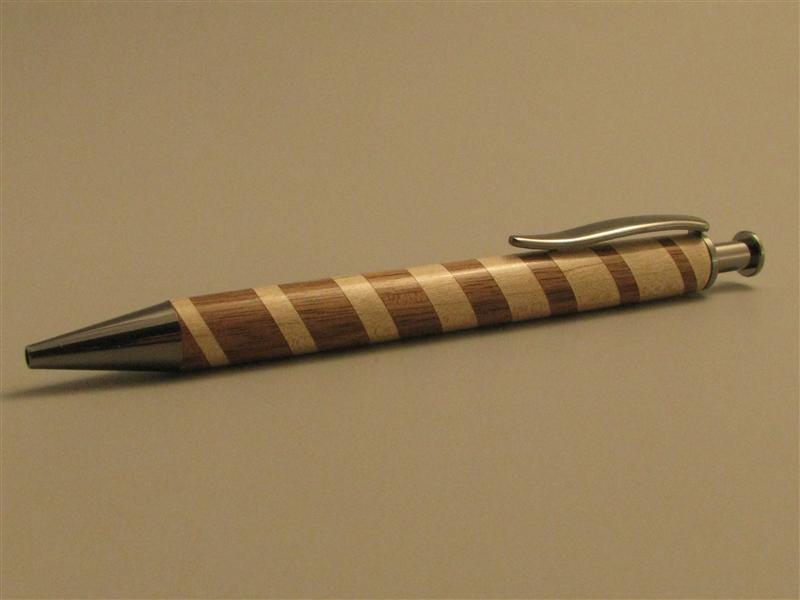

... of these Long Clickers, really like them. This is a Black Titanium wrapped in walnut and maple, cut at 45 degrees with increasing/decreasing width for each slice. This one was a lot of fun to make as I was able to use wood glue and did not have to smell the CA :eek:
Finally picked up some poster board to use as a backdrop, think it works a lot better. Next will be to get my lights working.
C&C's welcome.

what did you use for a finish?
I used 5 coats of thin CA, applied with a paper towel and buffed until set. This keeps any and all ridges away and leaves a satin finish. I top that with a coat of Mylands Friction Polish, this gives it the shine. Quick, easy, and as the friction polish wears away, a patina in formed on the CA and you never know anything was worn away.
