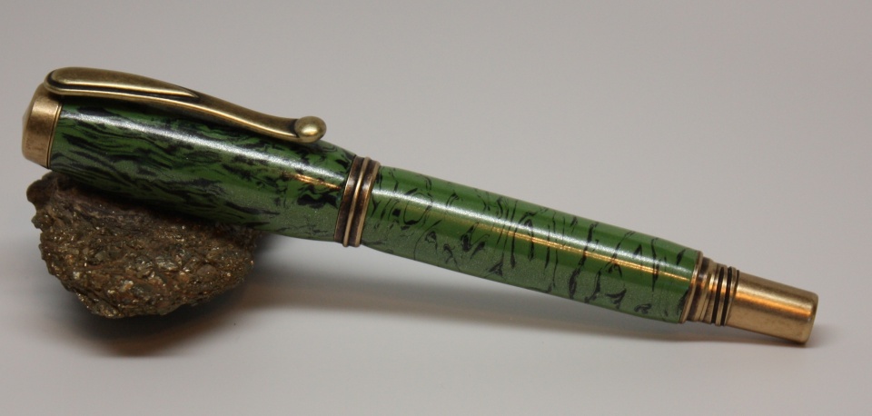

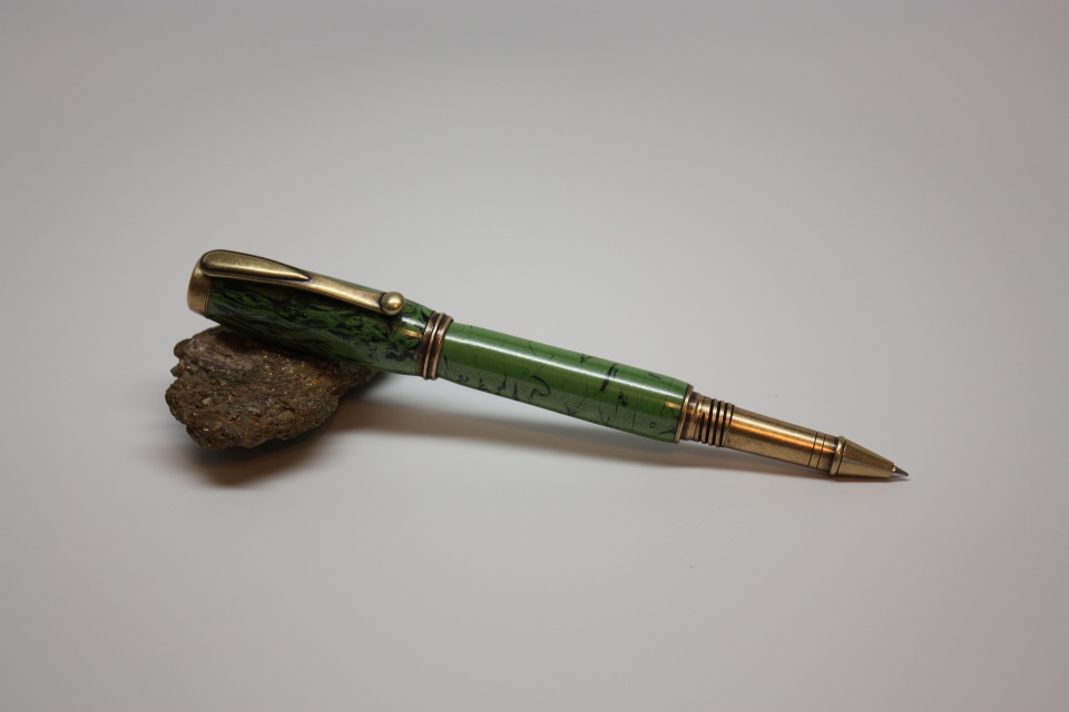

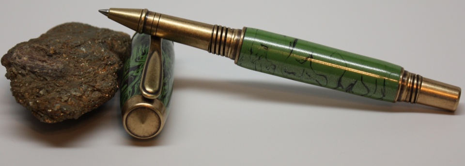

I just got a new MyStudio 20 and it looks wonderful. I really never learned how my Canon Xsi works other than pushing the shutterbutton.
Can someone help me understand what settings to make to maximize my new photo booth. Below is my first picture, it seems dark and has some reflection.

I shoot in manuel Almost 100 % of the time
Need to learn how to set a custom white balance .
https://video.search.yahoo.com/search/video;_ylt=A0SO8oZK16tVSj8AfZlXNyoA;
_ylu=X3oDMTExbGtvMmJiBGNvbG8DZ3ExBHBvcwMxBHZ0aWQDVUlDMV8xBHNlYwNzYw--?p=How+To+Set+a+Custom+White+Balance+On+a+Canon+Xsi&fr=mcafee#id=33&vid=
f011b8ad70d20f3e09df40452711be17&action=view
ISO 100
F11 to f32 depending upon the lens I choose to use
The higher the number the more DOF ( depth of field )
Camera to pen distance ( as close as possible )
Sutter speed.
If you are on a tripod you don't care what the shutter speed is, as long as the camera is not being or getting moved or shook .
And your exposure is correct .
Reflection
Filters is the only way to filter out reflection.
You can adjust angle of reflection though .
To filter out Polarized reflection , its best to understand how or why you are getting reflection AKA glare or white out first and adjust your pen photography so you don't run into these problems.
There is allot to understanding light and reflection,
I suggest the book Light Science and Magic.
I would also join a photography forum and get advise from experts .
I belong to Photography on the net forum Photography-on-the.net Digital Photography Forums
