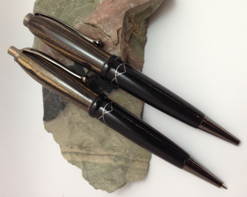

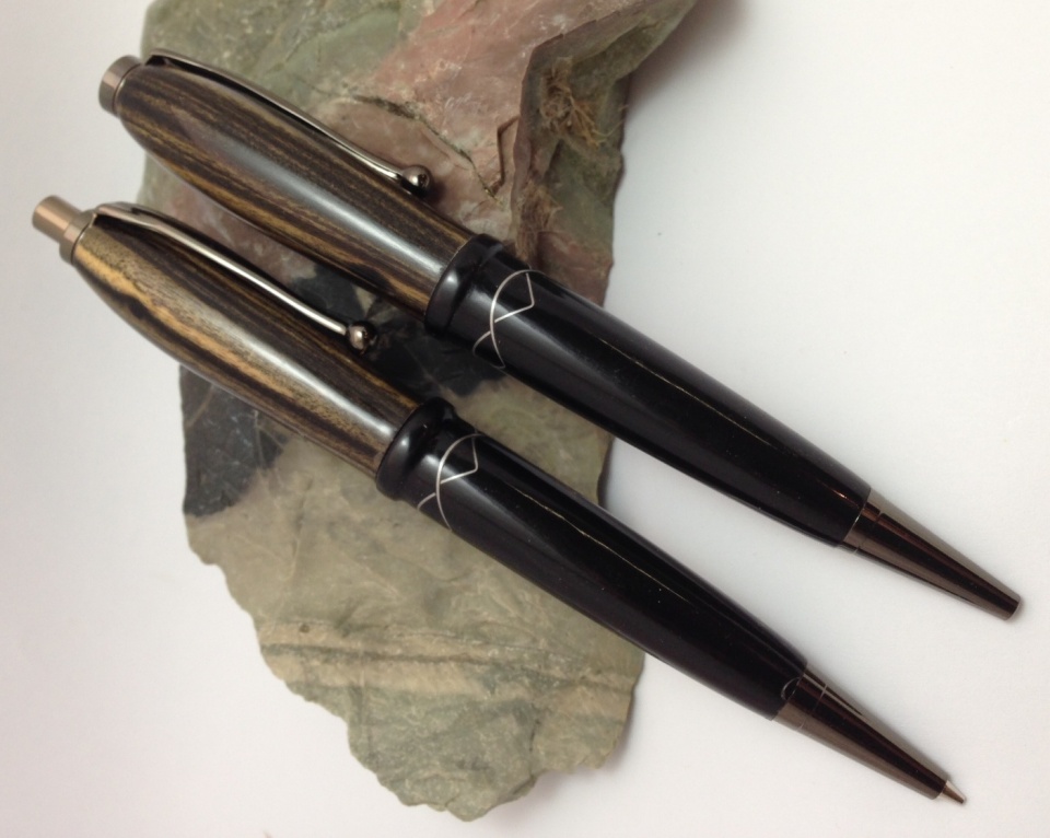

Hello, I am fairly new to pen turning and have come up with some black and pink ivory plus I have some blackwood and was wondering how a CA finish would work on these woods. If it doesn't what would be the best for a gloss finish. Thank you for reading.
Brad
Shore 'nuf can! Here's my gaboon and striped ebony pen-pencil set finished with CA and BLO.
attachment.php
Yes. This is Gabon ebony with CA.
I have had great success with pink ivory too. +1 on cleaning the blank with denatured alcohol before starting CA application.
