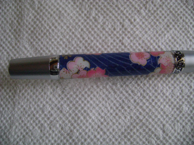

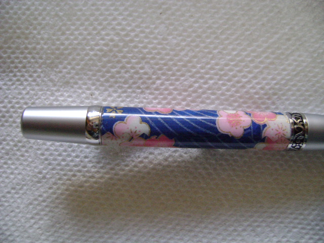

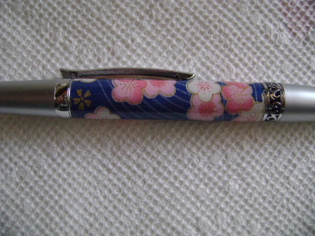

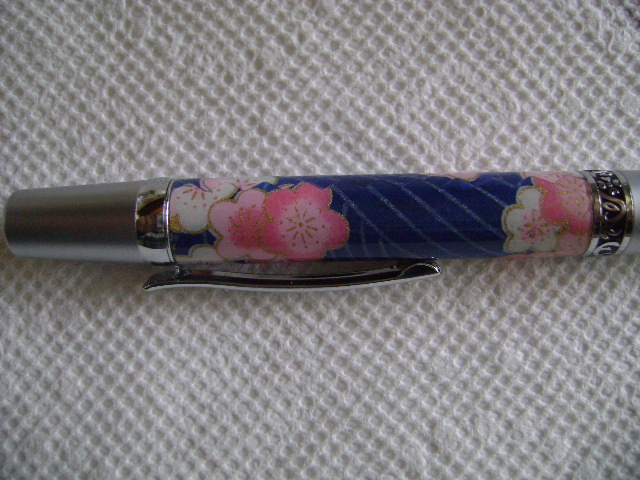

Hi alll,
I'm really interested in trying my hand at making the japanese paper blanks as they always look so good. My concern though is how does the join look? I see photos of these pens on here, and the pens look stunning, but I'm always thinking " what does the other side look like? "
Can someone help me out with maybe a shot of the join up side?
Janster
Nov 13, 2012
1,645
Nevada
..not so much.....
.......... "most " of the Japanese papers are so busy that the seam gets engulfed in the inherent design. Not much is parallel so it is quite difficult to see the seam. The colors and lines overlap and the human eye does not have a real "focal point" to grasp as it takes in so much info all at once. I know where the seam is and have to look diligently to see it.I shot these pics on Macro with a hand held Sony, tried to shoot them all from the same distance,all sides are covered. Some patterns cover better than others. Go for it and make some, they're fun! Good luck and be well.....Jan

DSC02208.JPG black patches; the question is how do i hide these lines.?
maybe spiral cut paper. over lap seems then cut down center of seem remove waste, make sure seem seem is smooth and fully glued down. some thoughts.
straight lines show faster than the spiral would.
Janster
Nov 13, 2012
1,645
Nevada
...That is as hidden as it gets. There will always be a seam, they just aren't so obvious unless you really scrutinize the pens closely! Be well...Jan

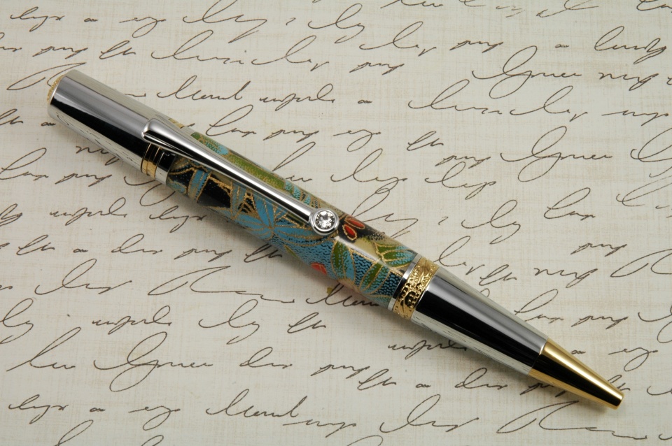

Hi alll,
Never, not ever, use a straight line seam…on anything. Just my .02¢
Here's a pic of the "other side". You're looking right at the seam at this angle. Find it and you win!:wink:
