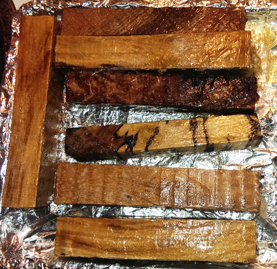

After a solid week in the juice they turned out nice..
I think I'm finally dialed in on 200 deg on that toaster oven..
