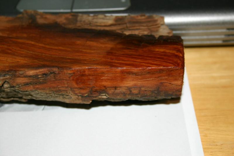

I picked up a piece of cottonwood bark and started trimming in with a knife, then did some sanding. The attached images are what I have after putting on a light coat of oil and some CA. Looks like a pen could be made from this stuff. What do you think
Dimension would be pen blank size or larger.
Anybody have any thoughts on this?

I know that the cottonwood Bark is nice looking after it is finished but I think it would be too soft for a pen.. it would probably get dents and such after some use.
I carve it and it is easy to carve but never thought about pens out of it.

I have lots and have made some pens, even scrolled some pens from it. It is very soft for turning. It'll soak up the CA which will harden it. So..it's ok, but it's nothing I'd call spectacular to look at, it is rather dark and bland when finished. My opinion is to stick to carving tree spirits from it.

I made a pen from fresh but thick pecan bark. No reason you can't. I dried it in the microwave first and then made a pen. Looked good and different.

Any material is a candidate for pens. If it doesn't look the way you like, turn it off the tube(s) and do something else.
