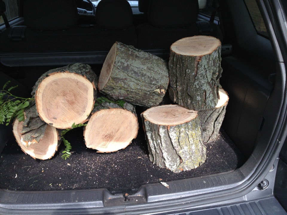

Got some free wood today from a tree that was blown down in a storm. Got enough to make 20 bowls or so. There are still some leaves on the branch at the left to help identify.

Possibly butternut but doesn't look dark enough. Definitely not maple.
There are several types of locust. Most commonly seen are black locust and honey locust. Look for spines. They will both have them - I don't think the butternut does.
Looks like locust to me. Probably black locust which is native to your area. We have honey locust down here where I live.

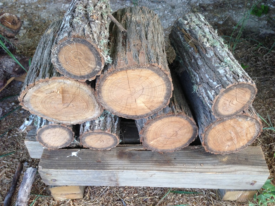

Here's some honey locust logs.
Yeah, I know - shoulda sealed the ends right away. Fortunately (I guess), it's quite humid here so they are drying very slowly & the cracks are not very deep at all.
Black & honey locust are very similar. Both have spines at the base of the leaves but honey locust also has long thorns on the tree trunk & limbs. Black locust does not. Other than that, you would need to look at flowers & fruit to be sure.

With the color the bark texture and leaves that is Honey locust for sure.
There may have been some very long red thorns on part of the trunk and limbs.

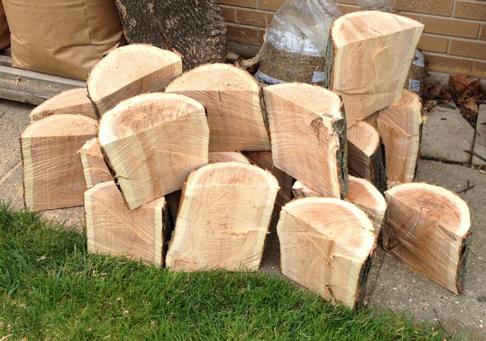

Got them cut up today. 20 bowl blanks in total. That little 14" Poulan electric chain saw I have did not enjoy itself one bit (even with a brand new chain put on). Not made for this size log.

Looks like the Locust I have growing in the back yard. Is that from that pesky little F1 we had blow through here the other day?

From the looks of the cut, are you cutting from the end grain of the log? It will cut way faster if you lay the block on it's side and cut with the bar parallel with the grain. You have to watch those long curls, as they will plug up the saw, but it's way easier.
