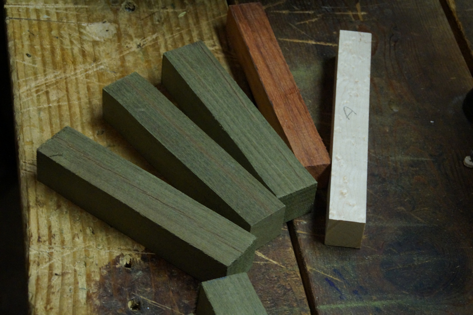

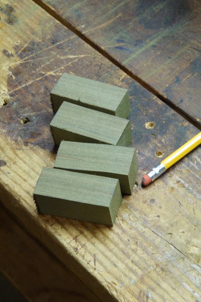

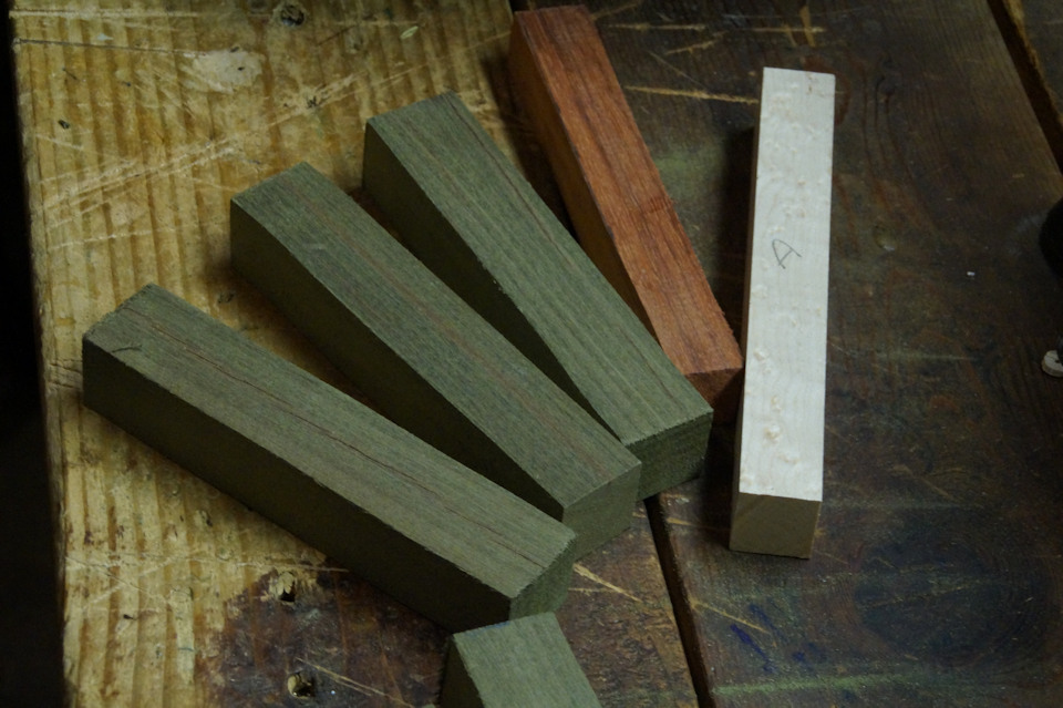

I have someone who is commissioning me to make several pen and pencil sets. He has given me two types of wood, from a late relative who did woodworking, to make the pens from. One is cherry (not shown) and the other was called mahogany. The wood thought to be mahogany is very green in color. I have always associated mahogany with more of a reddish color. I think the board I am cutting blanks from is quite old. Could age make the color difference, it does have a slight reddish vein here and there. Is this wood actually mahogany. I am looking for opinions. I photographed them next to some bubinga and birdseye maple just for additional color comparison.

It doesn't look any mahogany that I have. You're right it has a green tint to it. I don't know off hand what it could be. Is it a local tree variety or from somewhere else.

It might be vera wood or lignum vitae. I've never seen mahogany that looked anything like that before.
EDIT: Oops. I see Mr. Vaughan already mentioned these woods.
The cut ends appear to be as green as the oxidized outer surface , so woudn`t think lignum or vera . Does it seem to be about the same density as the cherry ? Possibly tuliptree (yellow poplar) although the uniformity of the green shade is unusual - might be a bit less dense than the cherry .
Could he have gotten a piece of Pink trumpet tree, Handroanthus impetiginosus, pink ipê, pink lapacho, is a native Bignoniaceae tree of America, distributed from northern Mexico south to northern Argentina. Thats the only timber that I know that stays green.

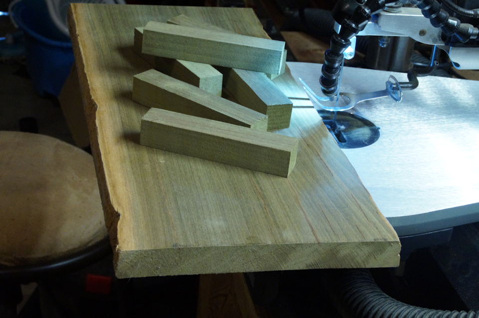

It is less dense than the cherry. Also, I did not mention this before, the board is weathered on one edge and has two nail holes in the other. It appears it is a board salvaged from either a structure or a piece of furniture left outside. The family comes from Kentucky and I would guess the wood to come from that area. I at least do not suppose it to be a piece of exotic lumber. I have turned to pens from it and the finish is drying today, I will buff and assemble them tomorrow and post a picture. The wood is olive drab turned and oiled as well.
I have seen similar color before and had a board that color about 30 - 35 years ago. What I remembered about it was that it came from a few hundred year of being water logged and dug up from a river bed. I had a board from a cottonwood tree that was dug up from a river bed that was blueish in color. (In his retirement years, my dad made custom sized shipping pallets and skids and had access to lots of different southern woods from many saw mills.)

I looked up tulip tree and it is a strong possibility. It mentions on Wikipedia that it as not only common in Kentucky, heart wood as pale green but also that is was used as siding. This piece I was given having the weathered edge might have been clap board at some point.

Re read your initial post . Do a cross cut where you have the most reddish vein . Red/purple in close proximity to green fairly common in tuliptree . Should make a nice pen .
