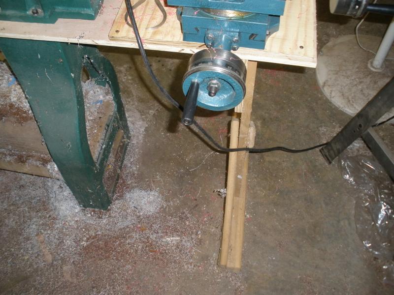

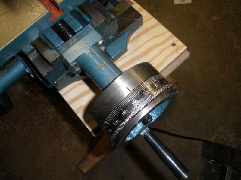

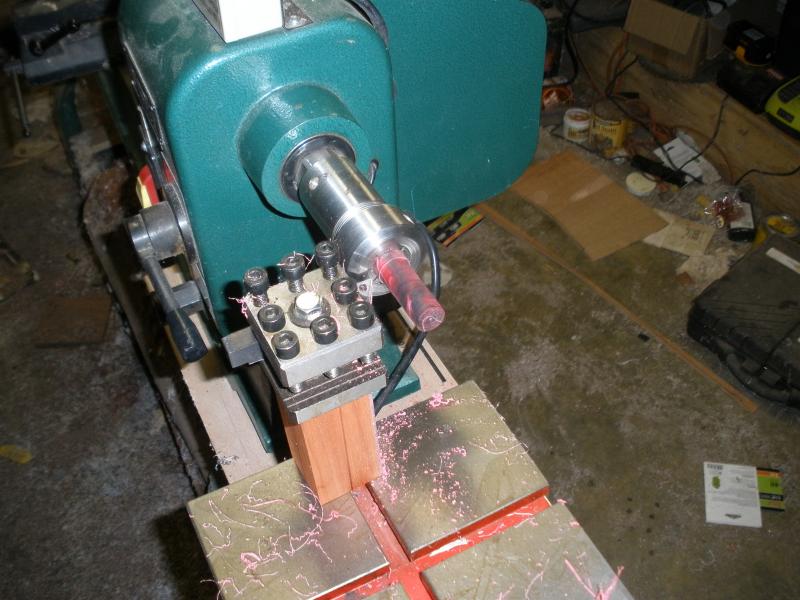

So off I went looking for a solution. Looking at the metal lathes what I wanted was that nice fancy cross slide and tool holder. Okay, those are fairly readily available. I have a nice 16 inch wood lathe, so I just needed to find a way to mount one to the bed. Easy enough? Sure. But I wanted the cross slide to be able to rotate so that I could make tapers easily. Not so easy to find. At first I thought I'd get a cross slide table and mount it on top of a rotary table, but that stack was pushing the capacity of my lathe even before a tool holder was added.
But I wasn't giving up. I decided I'd just go with the cross slide for now, and make the mount hold it in several preset positions to give me the angle I wanted. Then I found this critter. 4-1/2 x 12 Cross Slide Table for Drill Press The CST-501 right in the middle. So I ordered it. When it was delivered before Christmas I was shocked at the size and weight (70 lbs). When I lifted it onto the bed of my lathe and put the tool holder on top I knew it wasn't going to be a simple mount an go. Fortunately, the headstock on my lathe rotates so I devised a plan to put it on the outboard side.
The photos are a proof of concept. I will eventually make a pair of cabinets to replace the legs of the lathe and allow for more support. But it works. So if you can't afford a metal lathe, make one.

Mike -- you are about where shade tree machinists were working about 50-75 years ago. Work process will make a big difference in the precision and repeatability of your outcomes.
You will likely have some work to assure that your cutting edge is exact dead center on the axis, and the XY axis in both directions is dead on the centerline of the lathe spindle.

This one has the rotation built in, so no need for the multiple mounting points I was originally planning.

couple Aluminum shims to get the cutter to the mid point, took about 5 minutes. Along with the riser I made of Padauk (may replace later with a metal version).
and I have some adjustability in the mount for alignment purposes.

The mount I made is already pretty solid (I sat on it). The cabinets, once made will be like a rock comparatively and replace the lathe legs entirely and provide support under the headstock and cross slide table. The one cabinet will be fairly narrow, maybe 10 inches wide, the one under the headstock/cross slide will be about 30 inches. I need to leave the bed accessible so that I can adjust the other components so it can't be a full cabinet.
I will only be working plastic and soft metals on this. All prototype work for some other non-pen projects. but thought others here would be interested in what they could do for a couple hundred bucks.

I'm going to try to get back in the shop some this week and video it in action.
I think I want to add some flaps to prevent the swarf from gumming up the innards. I think I'll try a couple kitless pens to start so that I can get the hang of working it. Then its off to the races.
