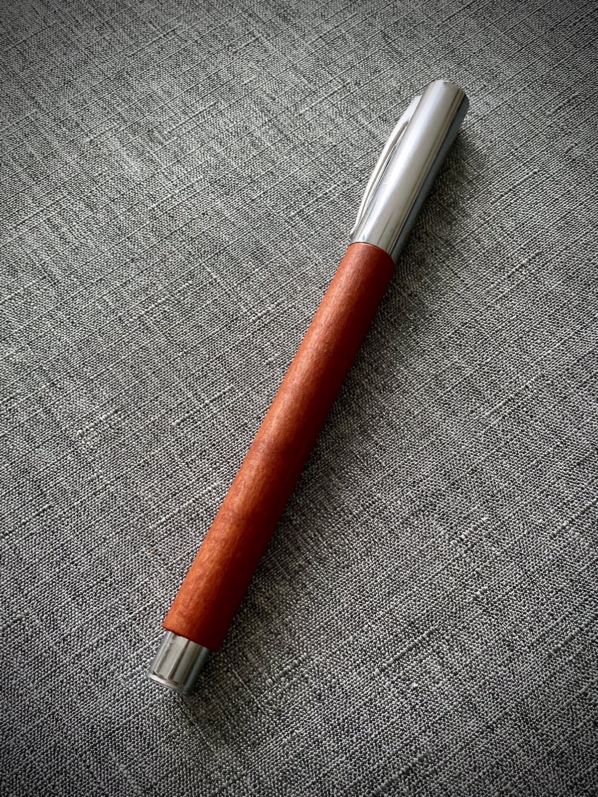

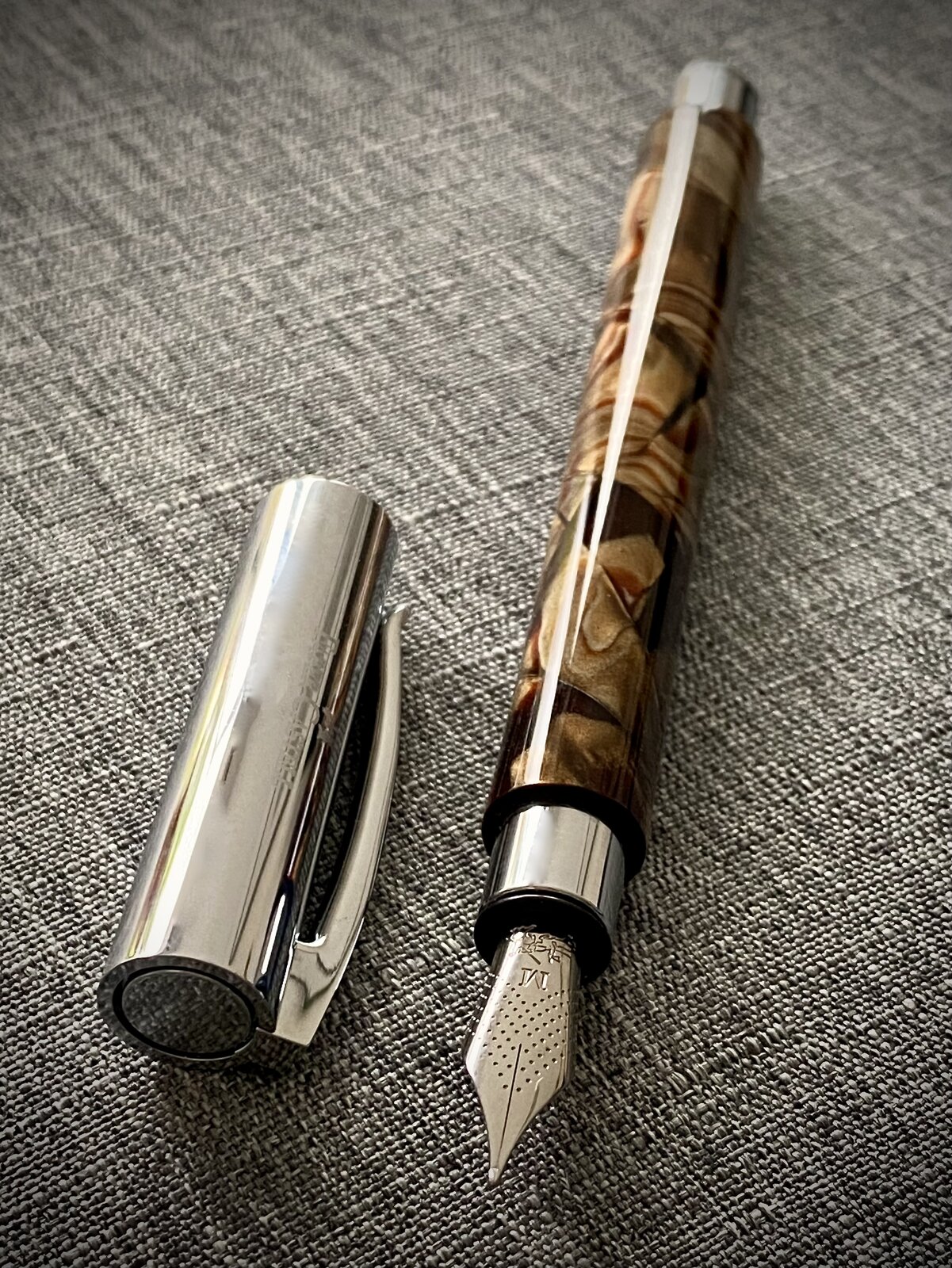

Are you talking about "re-dressing" a pen maybe? So you take something like a blue Pelikan 800 and strip off the blue resin and replace it with something if your own choosing?
I've seen this a couple of times but I've only done it with a very basic shaped Faber Castell Ambition model. It started as a reddish wood and I changed it to some vintage cellulose.
It involved putting on the lathe to cut away the existing material then replacing it with some material I'd drilled, turned and cut to size. I'm guessing that's the basic principle but I don't known about how other models are made and how you'd get them apart and whether glued, screwed, friction fit etc.
