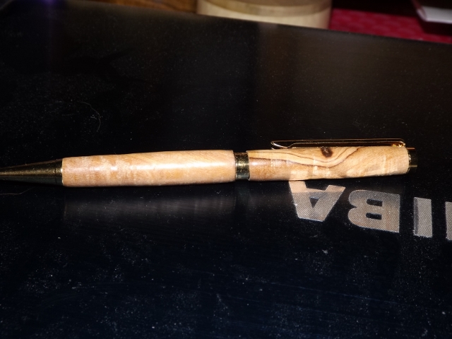

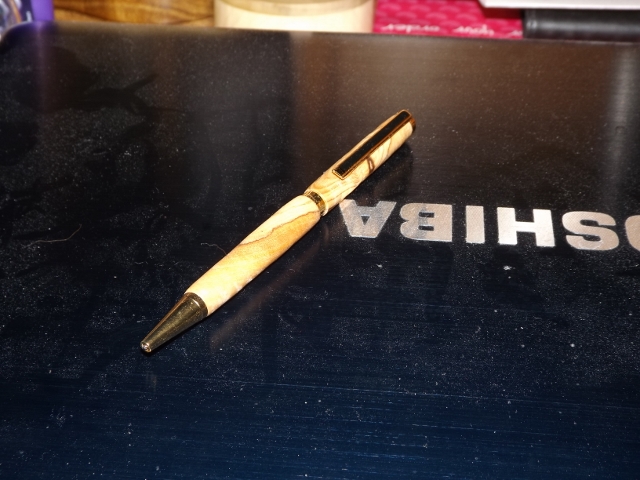

I just finished this pen and it is my very first one. It is not a real good one but I had a few problems with it. I could see a few mistakes as I put it together but next time I can do a better job of making a pen. After all I only have been turning for 2 days and this wood was so hard to work with. I will keep this pen so later in the future after making a few more of these, then I can look back and see if I had made any good progress. The wood had holes in it but I got around that ok. I can see I did not get down to the bushings like I wanted to. The twist doodad got bent and I was able to fix that and the pen writes real nice and the tip of the ink cartridge does not come all the way out for writing, but that was a problem I had with getting the twist thing down far enough. I'm proud of this pen any way. The wood is olivewood.. Thanks for looking at it... Fay

Welcome to IAP and congrats on your first pen, Fay. Don't lose it, it will always bring back fond memories for you. :good::good:
Hi Fay, and welcome.
I enjoy seeing first pen postings. You've identified what you want to work on for the next one.
I like the grain feature of your pen. I can't tell for sure, but it looks like you correctly aligned the grain so that it flowed from the upper to the lower barrel. Good work.
Regardless of any flaws that you see, or that others may point out, I would like to say that it is a beautiful pen. I love the grain on the top, it makes the pen look special.
Congratulation on your first pen, and may there be many more in your future...
Thank you every one. I really enjoyed making this pen and I will make more. I saw a site some where that had some pen blanks and hardware on sale but darn if I can find it now. I will order once I find the site but not able to find it but it's ok. There will be other sales. Well going to go down and turn for a little while.. Take care and have a great evening Fay

Welcome to the IAP Fay! You can correct the problem with the tip not coming out far enough by going back and pressing the transmission in a hair further. You can mount a bolt or flat ended screwdriver in your drill press and use that for a very nice arbor press, makes it easier to avoid pressing it too far. I used to use that when I first started turning pens. You just need to have a piece of wood on the bed so you don't damage the nib when pressing the transmission in.
