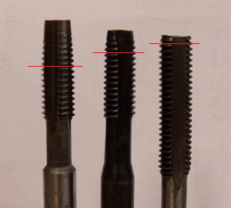

Stewart, the taps are the same, just the amount of taper varies to allow you to eventually tap thread to the bottom of a blind or shouldered hole. So you would start with a Taper, then use Plug, then Bottom. If you don't need a shoulder a the bottom of the hole then just make your life easy and use a taper. Easier to use and less likely to crack the hole as it takes lots of smaller bites before the thread gets full depth, as opposed to a bottom tap that will try and cut a full depth thread within one or two revs.....:wink:
Sorry, just read the link, Skip is correct you just need the taper tap, make sure you thread it in far enough to fully form the threads.
Stewart, here's a quick pic showing the different taps. You can see that the taper and even the plug, take several small cuts before a full thread is cut.
The more cuts you take, the less stress on the blank. :wink:
