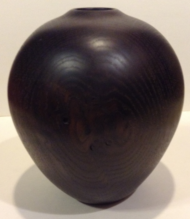

A really nice chemical dye for white oak is made from soaking rusty steel wool in vinegar. This will give you iron oxide, and that will react with the tannin in the oak. Gives you a very unique color.
