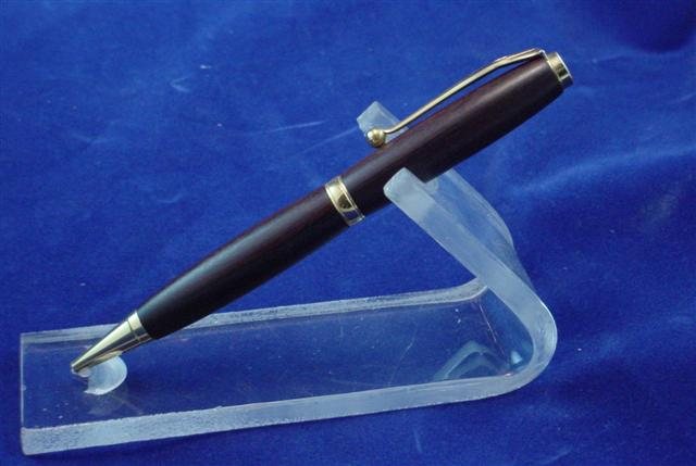

After considerable thought, I have decided to post this. Remember this is NOT "Show off your pens". I do not delude myself that this is a work of art. It is a walnut PEN. A $15 pen, taken off the lathe at a show. Yes, I did put a coat of RenWax on it last night before taking the picture. It was turned, sanded and "finished" in under 5 minutes. The finish is Hut polish, shellac based. It was sanded to 1000 grit, prior to finish. All turning with a 3/4" skew at 4000 rpm, sanded 240,320,400,600,1000 at about 1500 rpm. (Talking to the crowd and watching any pretty girls the entire time!)
Comments ARE welcome! [:D][:D][:D]

Originally posted by ed4copies
<br />After considerable thought, I have decided to post this. Remember this is NOT "Show off your pens". I do not delude myself that this is a work of art. It is a walnut PEN. A $15 pen, taken off the lathe at a show. Yes, I did put a coat of RenWax on it last night before taking the picture. It was turned, sanded and "finished" in under 5 minutes. The finish is Hut polish, shellac based. It was sanded to 1000 grit, prior to finish. All turning with a 3/4" skew at 4000 rpm, sanded 240,320,400,600,1000 at about 1500 rpm. (Talking to the crowd and watching any pretty girls the entire time!)
Ooopppsss! I buried it in your original post.
I'll give you $20...the extra $5 is for the lesson learned! [8D] (Regarding the pretty girls!)
